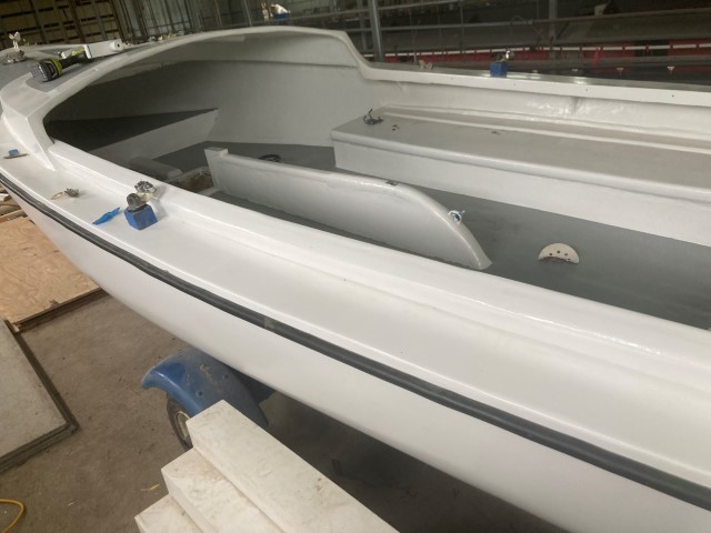

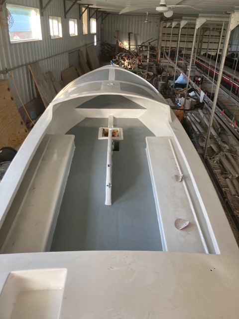

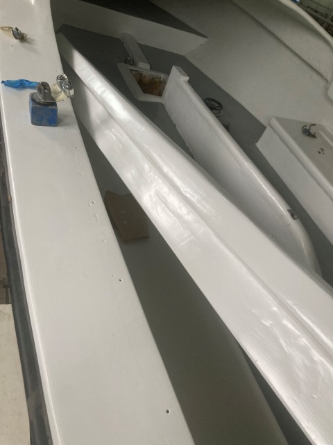

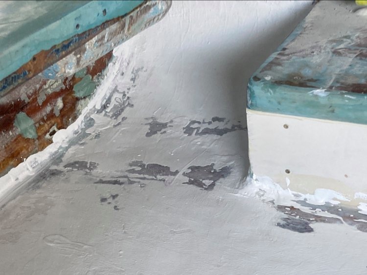

Painting going mostly well so far. Put on one or two coats of EZ-prime over the whole inside and outside of boat over two days. Washed first with their Bio Blue, as that made the most sense for me living on a farm with animals and so on. Sanded prime with 150 by hand just to frost it. Then mineral spirits.
Primer went on pretty well and filled, or at least somewhat hid, the many, many gelcoat cracks. They're still there, but now it's just "character" instead of crappy looking.
Surprisingly, unlike the matte finish green EZpoxy I just did my canoe with for practice, the semi gloss white on my boat has a ton of orange peel, and just general weirdness. Like some sags even which I didn't get at all with canoe. Not sure if I put the white on too thick or what...All I can think is that maybe it's also just the glossiness shows it all off more? But I was using the performance enhancer like before, it wasn't thinned or seeming to need it, and my roll and tip technique is halfway decent so I don't think it was that.
Although one difference was I used my screwdriver paddle to stir todays white Ezpoxy and it was suuuuper bubbly for the first half hour really of rolling it on. Dunno if that was all from me or what, but I was knocking down probably 1000 bubbles every 18-24" of tipping...
Anyways...gonna sand that soon with 120-220 for second coat. Not sure how much I want to take off to get it smooth again, or if I should just sand it lightly and trust that I can always wet sand/polish the orange peel and unevenness off later.
I'm also just glad we're getting this heatwave in Wisconsin so I have perfect painting weather.

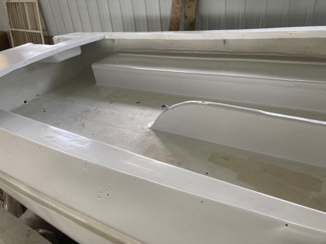

Have benches and centerboard walls painted, everything else just primed.
IMG-8864 (Small).jpg (67.96 KiB) Viewed 297847 times
Will do anti-skid pads with EZdecks. As well as the floor.

Got a warm day and put the second coat of Ezpoxy white for topcoat...but this time I sanded with 120 grit beforehand and after coat I can see sanding scratches all over on boat. I'm now assuming when they said sand with 120-200 grit between coats, they didn't mean 120 OR 200, lol...
What would be my easiest option, considering painting days are getting hard to come by, and I still need to do the non-skid? Should I just suck it up and 200 grit sand and do a third coat, or can I get those scratches out when (and if) I wet sand the whole boat to polish it up? Thanks.

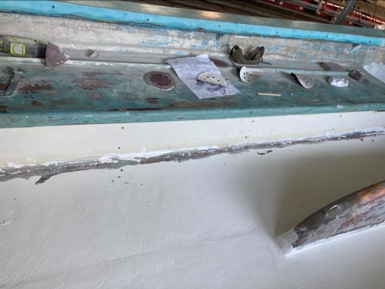

Postby marcusg » Sun Jun 05, 2022 12:01 am

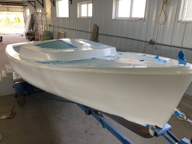

So, after all the repairing of the past two years, the paintjob is pretty much done except for a few last coats on the furniture and rudder. Starting to put things back in place and remember what went where and get new bolts and nuts for the corroded ones.
IMG-0230 (Small).jpg (80.74 KiB) Viewed 296593 times
One question, though, is about the coamings. As you see in the pic, mine are a special custom set that came with the boat (that I painfully refurbed.) And there's a 2" or so "ledge" that overhands on the outside of the deck, between the seatback and the guides/clamps. When I took the coamings off, they each had a long flat strip of silicone between this ledge and the deck. If there's nothing there, water will be able to get under there and drip right onto the seating surface. I don't have a ton of experience with using silicone, other than to seal woodstove pipes going through the roof, but I imagine I'd buy some kind of silicone caulk, and then sandwhich that between the coaming ledge and the deck (of course, only once I'm ready to screw the coaming on and have everything set to attach it.) Any thoughts or any specific type of silicone?

Postby GreenLake » Sun Jun 05, 2022 3:54 am
From a marine supply store you should be able to get a special closed-cell foam weatherstripping tape that you can tape between the deck and the coaming. You would place it as far to the water side of things as possible, where possible is defined by whether there's a consistent gap narrower than the tape, so it stays compressed a bit for a good seal. That should keep the water out. I'm using that for my regular coamings, which are just straight boards, so there I placed the tape at the top edge of the gap.
You can get various types of foam tape, so check around. It shouldn't need to be wider than 1/2", but it needs to be thick enough for your gap. Some run up to 250 mil, that would work for rather substantial gaps, even accounting for some compression. The shop I used to get mine from, now advertises only something that's more than double the length you'd need for DS coamings and more than double the width, so you may be better off looking at the 3M site and see whether you can order there directly or get a dealer or online source for the correct product number.
