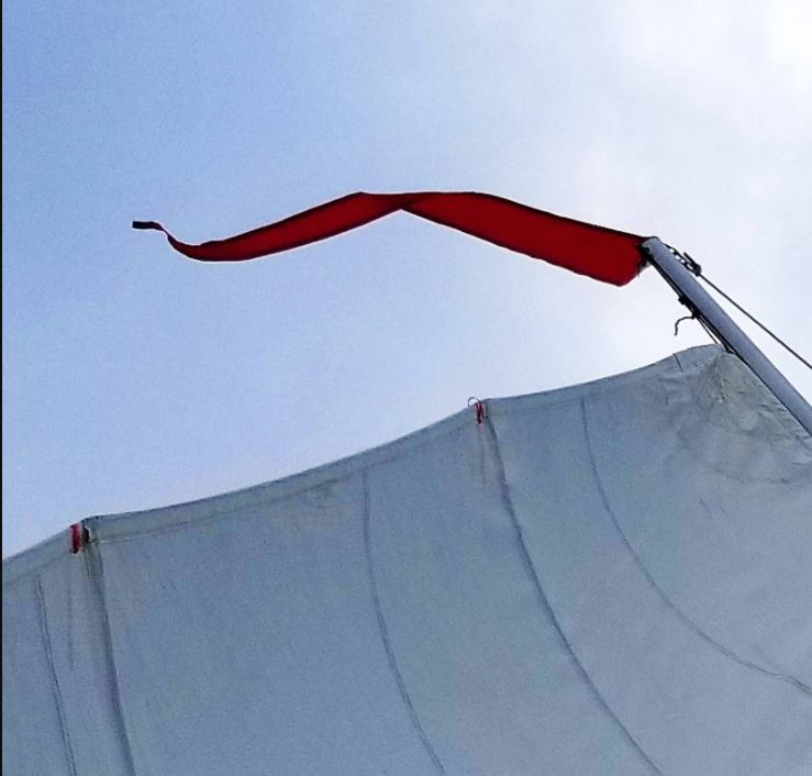

Anyway, I digress. Look, those Laser strap—on indicators are too small to get on your mast and impossible to use if you have external halyards. If you want to experiment with a masthead indicator, just get yourself a small flag or streamer and bungie or rubber band it to the very top of your mast. You won't have the little tabs, but is just as good for seeing the wind as a windex. Like so:
For that matter, you can put a bit of ribbon or telltale tape up there, harder to see but still useful. Likewise, try putting indicators on your side stays. Going upwind, the indicators should fly parallel to your mainsail, actually the other way around.. trim your main to match your side stay indicators. Again, can be a bit of tape, wool, ribbon, whatever, but I treated myself to these (on some super sale, of course):
