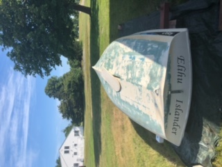

I'm continuing with this thread since multiple searches both general (using Google), under Repair and Improvement, and in the thread Basic Painting Questions didn't turn up the information I am seeking ... at least in a way that I could take it in. I've also read West Marine's prep instructions on its DIY Bottom Painting site. https://www.westmarine.com/WestAdvisor/DIY-Bottom-Painting Apologies in advance for duplication / incorrect thread / ignorance / length. The sailing is easy and I know how to paint, but the prep part is pretty much all new to me.
I have now got my boat upside-down: Collin Casey's 3/1/2004 step one. :)
My step two was cleaning algae with a plastic "steel-wool" scrubby, scraping barnacles, then washing with SimpleGreen, rinsing with water, and wiping blue paint residue.
The hull is now about 20% gelcoat and 80% old bottom paint (ablative antifouling applied with a brush). Some of it (brighter blue) is quite hard. Other parts are thin and came off when I scrubbed scum with my black scrubby. See photo.
Hull after initial cleaning
Neither the centerboard trunk nor the CB has ever been painted. My plan for both is to paint the areas where there was algal growth (thanks GL). This works out to about 6–8˝ in the trunk and 8–10˝ on the leading edge and sides of the centerboard.
I am now realizing that I haven't considered what additional prep work may be involved before painting. I am not racing this boat and don't really care about appearances, but am willing to invest time, effort, and dollars now — using my weekend time — for savings of all three down the road. Hoping, however, that I can be out on the water by the end, if not the middle, of July.

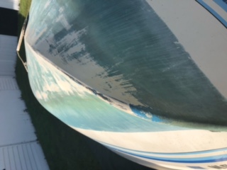

Condition of hull: Apart from the blotchy paint remains (and centerline issue described below), the bottom surface is in very good condition. No blisters, cracks, etc. And no leaks. She floated high and dry on her mooring for three months last summer.
Condition of centerboard: leading and bottom edges are worn through the gelcoat but firm and intact. Sides have lots of cracks . . . some radiating (spider cracks?).
Considerations, Issues, and Questions:
  • Keel/Centerline under the bow. A stretch of about three feet is pretty worn -- through the gelcoat. Close up, I see some dark green and black. See photo.
    Keel under bow
    Question 1: What preparation, if any, should I be looking at for this edge that probably gets the most wear, coming up on a beach, for example. (I had a roller added to my trailer last year so the boat no longer drops to the trailer frame when launching!) Is there a post that would fill me in (pun intended)?
  • Centerboard - leading and bottom edges (also side cracks).
    Question 2: What preparation, if any, do I need for the CB edges? Is is the same as for the keel/centerline?
    Question 3: Can I ignore the side cracks (at least this, my second, year)?

Question 1: I'm with GL, you probably damaged the bow on the trailer, not beaches, dont worry about it. Fix any obvious dents/gouges and then sail on. Anyway, beaching on sand shouldn't harm your paint (much) and I don't beach on rock or pebbles, I anchor off a few feet. Let out an anchor astern, hop overboard and take a line forward to tie off to something on the beach.
Questions 2, 3: I'm with GL again. Put filler for any obvious dings/cracks, sand it smooth
