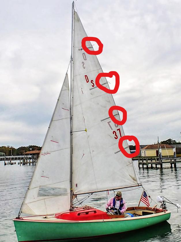

Speaking of sail-trim: I don't see any telltales at the end of your main, Tom. You do want to monitor the flow at the leech, which usually means a streamer at each batten pocket. The ones you have only tell you what the flow is like on the first third of the sail.

In the meantime, I DO have leech telltales on my main, 3 inches above each batten pocket:

Leech telltales

You can see the top two pretty well, but the bottom two have wrapped back around the sail. Note also that the main is luffing - a big bubble all along the mast and my luff telltales pointing off forward or just hanging down. Remember, I was in mid-tack, still sheeting the jib in - look at the position of the clew. and I've left my bungee "auto-pilot" in charge of steering.
For Gary, this is just to point out that you have to consider the whole sail-plan, from the forestay all the way back to the main leech as one big wing, keep the air flowing smoothly across all of it. The most important telltales are the jib luff, to see the air coming onto the sailplan, and the main leech, to see it coming off. Also, notice that the top 1/3 of my mainsail, above the "DS" logo" has good flow, the rest of the main doesn't. This because it's in "clean air", not affected by the jib - the top leech telltale is streaming nicely, the next one down is at an angle, the 3rd one is flipped behind the sail, and the bottom one you can barely see against the treeline, hanging pretty much dead. Once I'm done my tack and have the jib set correctly, one hopes that the air flow reattaches to the main and all those telltales straighten out, flowing straight back again. But at the moment of this photo, only the top part of the main and the front-most part of the jib are driving me, the rest of the sailplan is just along for the ride. And you'll note that I'm barely moving, no wake, just a few ripples.
Note that I was sailing in VERY light wind, maybe 2mph. Winds are usually weaker and more turbulent near the surface (lower), especially in light conditions. So even after I get the sailplan settled down, I'll probably still be getting most of my drive from the top of the mainsail. Moral of the story - watch your entire sailplan, but depending on conditions some parts are more important than others. When I'm sailing, I'm constantly watching my sails and the wind - on the water, on trees, and flagpoles, and on my windex, and on nearby boats, even the flag on my transom gives me some wind info. Other things - running into other boats, the shoreline, etc - are also important, but occupy maybe 10% of my "scan." Of course, a good chunk of my "scan" also is looking for another beer in the cooler :)

Tom. In light airs like that, if you have a topping lift, you might allow it to take some of the weight of the boom - so that your main can twist (wind direction changes with height).
Otherwise we are in agreement on this. (I'll have to re-read Gentry on the triple tufts near the jib luff).

Gl: You're absolutely right re: topping lift. Yes, I have one and I use it that way. To be honest, for these photos, I was just "messing about." My son was with me and I asked him to take some photos of me sailing, since I don't have any. So I dropped him off at the dock, fell off downwind and made a few lazy tacks back up to the dock. If I had been "actually sailing," I would have trimmed better (I hope!).
