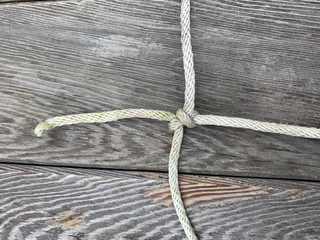

The line for the traveler system on my boat has an interesting knot completing the loop and providing a tail for adjustment.
Looking to replace the line, have not been able to identify the knot, nor so far able to replicate it.
Has a couple of twists and the knot either ends or starts with two half hitches. Interesting to me on how it is tied.
Could replace the knot with a bowline knot, but what I have is an interesting knot.
Any thoughts on ID?
Rob

Huh... seems to me as if someone tied an overhand knot into the bight on the right hand side (slightly pinker line in your photos) then popped the end of the rope thru the loop and tied it off with a clove hitch. I can't imagine that having a specific name, but I could very well be wrong. And I have no idea where I put my Ashley's, but if this is a real knot, then it'll be in the ABOK in the chapter on hitch knots.

Correction, it's a slip knot in the bight.

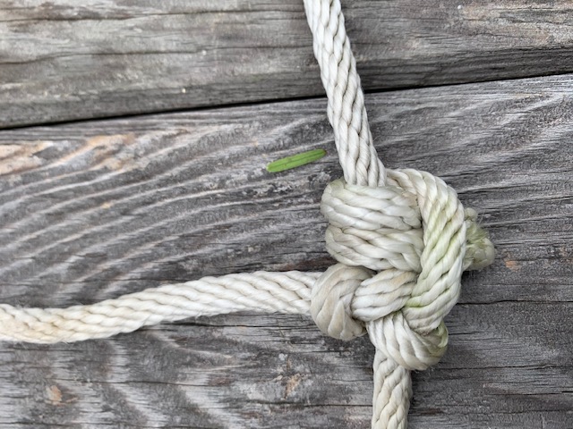

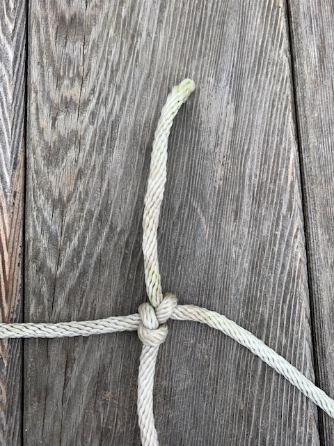

Not quite the " adjustable grip hitch" but when I take the two half hitch knot out, I now can see that it is indeed a slip knot. Added some additional pictures.
This slip knot however is SO TIGHT, that it never would slip / be easy to adjust. Looking for my marlin spike as I can not undo the slip knot at all.
Hear you on the bowline, not being adjustable without retying completely / not being under load, etc. but this knot is not easily adjustable either.

Rob, you have an overhand slip-knot that somebody tied a "midshipman's hitch" to. (For that part they should have used a buntline hitch - which is almost he same, except the clove hitch is inverted, so it holds better). Instead of the slip knot, use a butterfly knot - it makes a secure loop for attaching things in the middle of a line.

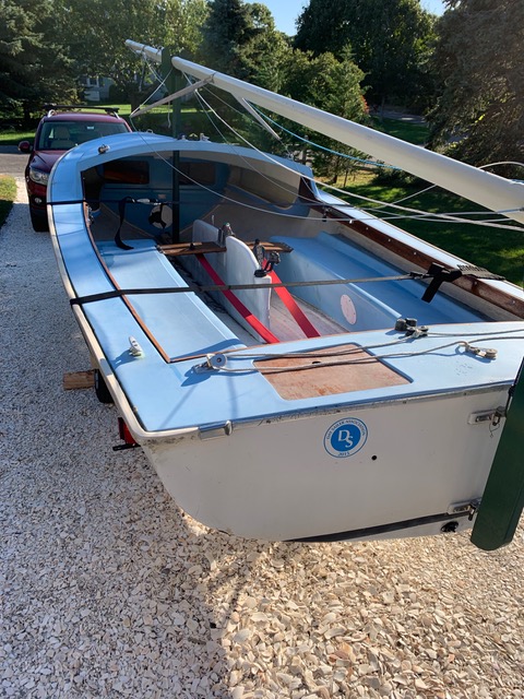

Here are two pictures of the way the PO had traveler set up, which I am replicating but with new hardware and line.
You can see the knot we are talking about in the first picture leading up to a block, "tail" of line then leading to the cleat. The knot closes a loop in the traveler line. Loop runs through the two deck mounted blocks on either side of the transom, and the "top" of the loop has the block for the main sheet.
Not to get off track, but for clarification, the main sheet starts from a becket on a block at the rear of the boom, down & through the traveler pulley, back up to the aft boom block, forward to a racket block, down to swivel base cam cleat mounted on the center board housing.

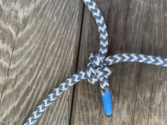

GL so played around some and see how I can use a sheet bend knot on the traveler line to close the "loop."
It is a little smaller than the bowline knot I had, but by not much.
Here's a picture of the current traveler set up, butterfly loop at the top, sheet bend at the bottom.
A couple of close ups front / back of sheet bend.
I am using 7mm Bzzz line which I had originally bought a sheet, for the traveler line. It is very soft and flexible... will the sheet bend knot stay tight / tied? Seemed like the bowline was loosening up some when not under load.

Rob, just looked at your pictures again and I see that you are using a sheet bend, but you use the tail from the other end (blue in my picture). I suspect, there's a slight chance you can capsize the knot if you make that end the "tail", that's why I did it the other way around.
