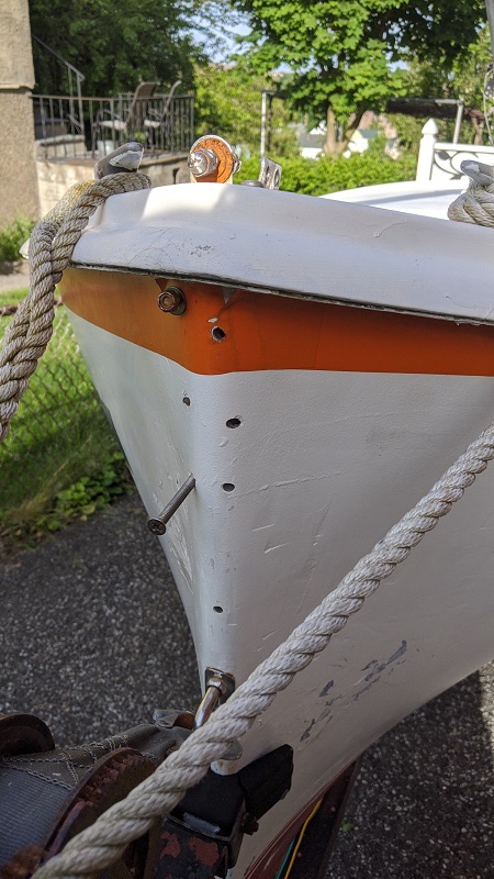

Orignal, barely touched
Original bow "repair"
orig bow.jpg (150.11 KiB) Viewed 17808 times

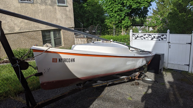

Ugly stern
orig stern.jpg (140.38 KiB) Viewed 17808 times

I'm really puzzled by those drill holes that PO put into that boat. What were they trying to achieve??
Looks like you got at the root of the issue, which is anchoring the stemhead fitting. The deck is not supposed to carry any loads, of course, so the screws you put in are mainly there to make it line up with the hull again (I take it that it was gaping from the stemhead fitting having pulled loose?).
Can't help you with finding the cheapest way - my attempts at optimizing are trying to delay future maintenance as much as possible. Some cheap stuff may be amazingly durable and some more expensive stuff may fail prematurely - my conclusion by now is that it's impossible to tell beforehand how long something will last, unless you've already done it once.
Re: DSII Restoration Project -- The Millennial Falcon
Postby ElCapitan » Fri Jun 05, 2020 5:14 pm
So what the PO did was totally unnecessary and poorly conceived, but I get what they were going for. (Also, in the event that the person I bought this from ever pops into the forum, let me clarify that it was the PREVIOUS previous owner who did this work. The most recent owner was going to restore this but didn't get around to it as he already owns two DS1s. So when I say PO, I'm always referring to the one before last!).
Basically they had tried to create a new stemhead entirely. Why? I don't know, since the original was still there. They took a long SS tang (like 12"), slotted it through the deck, and then through bolted it a bunch of times into the bow. I would say that structurally it was probably sound, but was a hideous and totally unnecessary way of doing it. They also *attempted* to seal the deck gap with ungodly amounts of Bondo inside the bow that thankfully scraped off completely in 5 minutes because of how sloppily it was applied.
As far as my bolts through the deck, the main concern was that I was having trouble getting clamps to really squeeze the deck and hull together effectively, so this made the 5200 seal perfectly. Secondly, I always like to have mechanical fasteners to support adhesives whenever possible, just to improve lifespan due to the inevitable flexing that will degrade the adhesive over time. I take no issue with the appearance of the bolt heads (well, once I get the last finish washer!), and figure that is essentially a "permanent" repair now. A little overkill, but one less thing I need to think about!

The bolts are definite overkill, the way I see it, or, I should have said, there are other means of ensuring that the deck stays down, but that's an academic point. It's your boat and you're happy with it, that's what counts.
