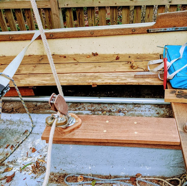

Health, bad weather, and actual paid work have been slowing me down in my project.. excuses, excuses. Anyway, some progress, I got my Console Tree shaped and sanded, and made my Centerboard Cap:
Cap and Tree
Also mounted my mainsheet swivel cam/jammer:
Jammer
The "hard part" of all this was driving screws from the top part of the cap into the top edge of side rails. I'm using Tigerwood, a tropical hardwood almost as hard as Ipé. So everything had to be measured thrice (with digital calipers) and cut and/or drilled VERY slowly to avoid breaking bits. But now that I'm past the fiddly part of this project, it's on to the fun stuff... installing hardware! Or, as my wife calls it, "boat jewelry. " :)

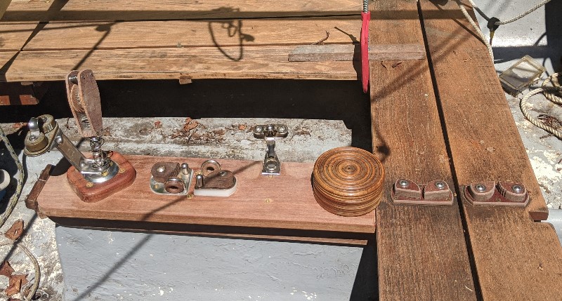

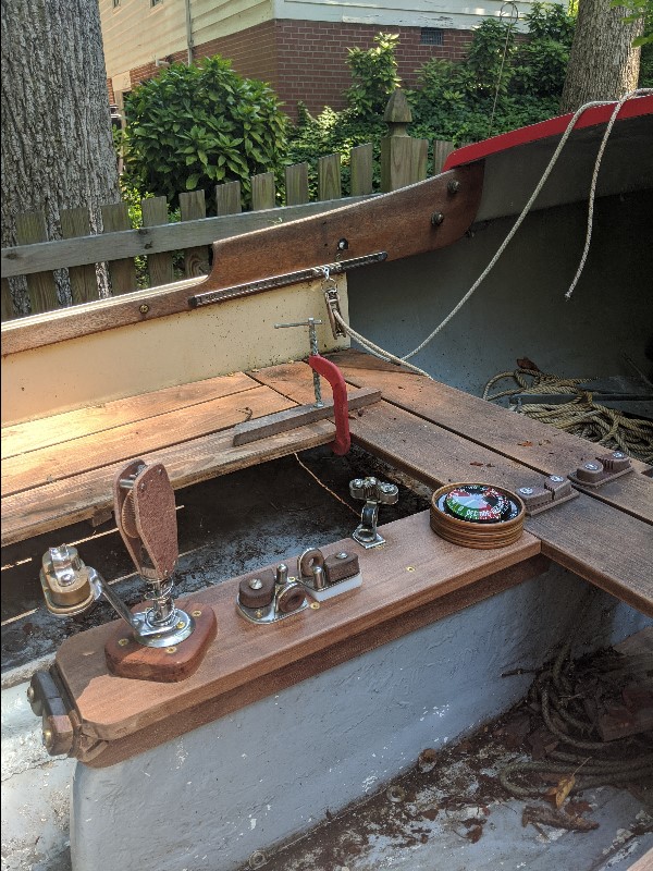

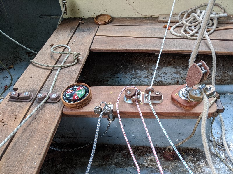

Finally finished my Centerboard Cap, with all attached doo-dads and hardware. Lots of measuring twice, cutting 3-4 times, with copious cursing in-between! Some pics, as always please don't mind the mess.... boat's been sitting out all Spring with tons of vegetation falling into it at every rainstorm, not to mention the usual construction debris.... really needs a good hose-down and scrub. Anyhow:
Cap from Aft
From the rear (left side) to front, I've got a cleat for the spinnaker halyard, the mainsheet swivel cam/jammer, cleats for the spinnaker sheets/guylines (depending on which tack), a tube-swivel cleat for the vang line, a tactical compass, and cleats for my jib sheets on the thwart. I'll admit that it's a lot and may be too cluttered, but I think it will work for ME. Keep in mind that I'm not racing and I'm usually sailing solo, so I wanted everything close at hand for where I usually sit, about 18" back from the cuddy. I'll also admit that there's no good reason for the tactical compass except that I saw it in an antique shop in that nice walnut box and just couldn't resist. It's got a cover for when I'm not using it (and I put a mayonnaise jar over the whole thing for when it's on the trailer):
CB Cap, compass covered

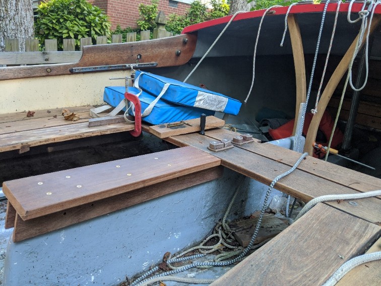

Anyway, all the hardware is screwed and glued to a 3/4" plank which is itself screwed and glued to two "side rails'" which are then thru bolted to the top of the centerboard case. The bolt-holes are about an inch from the top of the case, don't interfere with the CB at all, but I'll have to put some caulk at each of the holes to avoid weeping (right now, the cap is just test-fit onto the case). Most of the time, I'll be sailing with main- and jib-sheets either in hand or cleated down (depending on wind speed/steadiness) and grabbing the vang-line as needed. So not too cluttered, I hope. On the other hand, with everything set, you wind up with this:
Testing the lines
Which I admit is a bit much - from left to right it's jibsheet, compass, vang, port spinnaker sheet, star spinnaker sheet, mainsheet, spin halyard. But remember, when the spinnaker is set, the jib will be down, the vang will be pretty much full on and then not touched, ditto the spin halyard. I'll only be playing the spin sheets and the main, so hopefully will be manageable. I've also set up my turning blocks for the spinnaker sheets, which I'll show in the next post....

Nice, I really like the tactical compass. It will be very useful if you sail in big waters. We used to take a heading when entering the fog so we would have a general idea where we would come out. All your old school hardware add a nice touch.
Could you measure how high your centerboard cap is above the sole? I'm looking at doing something similar.
- Rich

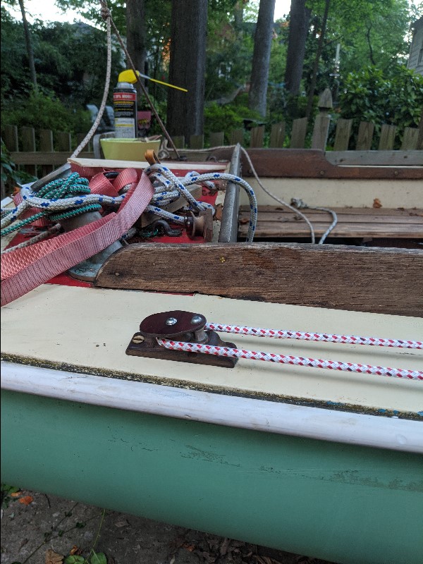

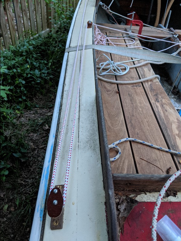

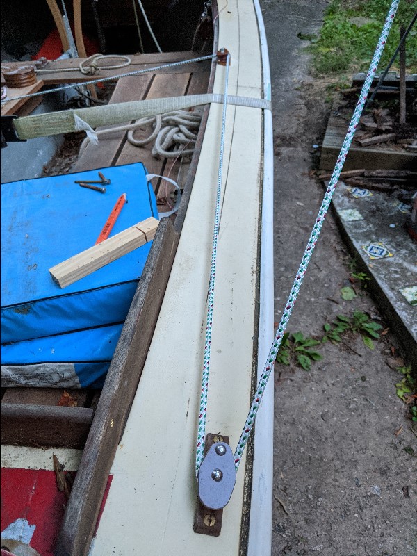

Wanted to show my spinnaker sheet setup and would welcome any thoughts. Per suggestions on these forums, I'm leading my spin sheet/guy back to a turning block aft then forward to another turn about where I plan to sit:
Starboard (Spin Sheet)
Port (Guy)
These shots are from aft looking forward, you can't really see it but I've placed the forward deck blocks exactly one "Tom's-Butt Width" aft of the turn in the coaming. In other words, I've given myself space on deck to sit where I usually do. Yes, I know that I may have to scooch aft with more wind, but I can sit either aft of the deck block or with it between my legs. I can even sit ON the block (digging into my thigh), as it's only an inch high even with the pad I built under it. I'm more worried about sitting on the the guy line, as it runs along the deck - it gets held down to the deck somewhere near the side stay (details TBD), then aft to the turning block, then for'd to the deck block, then to the cleat on the CB Cap. I couldn't run it under the deck because of my side-tanks, I have a VERY early DS1. Of course, it won't matter if I'm sitting up on the deck, which I usually won't be on a run. I'm also wondering if I really want to run the sheet (as opposed to the guy) thru a cleat, I'll need to be constantly playing the sheet to maintain the curl, so may want to just hold it. We shall see, and the truth is will have to sail with the spinnaker a few times and test this all out, then make changes as needed.
Also, I don't know how much of this setup I will leave rigged when I'm not flying the 'chute vs how much extra setup work I want out on the water (getting ready to set the chute). I deliberately chose a turning block with no "back", so that I can just loop the sheet over it at "go time." Will it work or will my lines pop off the blocks at the wrong time? Well, as Caesar would say, we'll cross that Rubicon when we get there:
Turning Block
Of course, as Caesar also would say Alea iacta est, the die is cast. In this case, the epoxy is cast, I've both screwed and epoxied these blocks to the decks, so moving them will be "interesting" but not impossible. Let's sail first.... :)
Thanks for your patience in reading all this and please let me know any thoughts, cautions, or advice. Iv'e put a lot of thought and test-fitting into this setup, doesn't mean though that I won't be changing it as needed.
Re: Quarantine Projects - Hull #37
Postby GreenLake » Mon Jun 15, 2020 6:33 pm
Nice setup. What I do with spinnaker lines is that I lead the tails all the way forward when not in use (in fact, I hook them behind the coaming). They are tensioned a bit, but out of the way. I do that the minute I'm not flying the spinnaker, that way, I only deal with the sheets in the cockpit when they are active.
