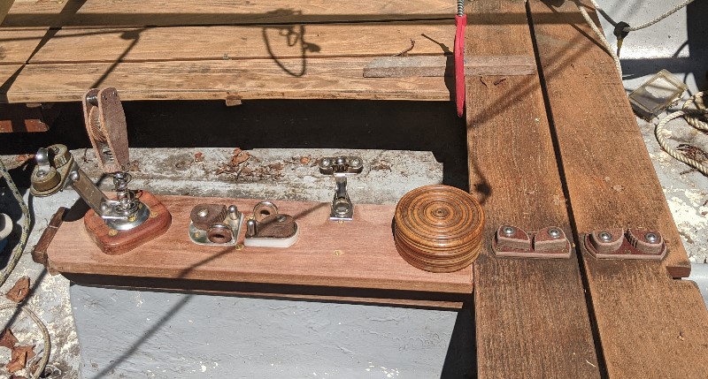

Health, bad weather, and actual paid work have been slowing me down in my project.. excuses, excuses. Anyway, some progress, I got my Console Tree shaped and sanded, and made my Centerboard Cap:
Cap and Tree
Also mounted my mainsheet swivel cam/jammer:
Jammer
The "hard part" of all this was driving screws from the top part of the cap into the top edge of side rails. I'm using Tigerwood, a tropical hardwood almost as hard as Ipé. So everything had to be measured thrice (with digital calipers) and cut and/or drilled VERY slowly to avoid breaking bits. But now that I'm past the fiddly part of this project, it's on to the fun stuff... installing hardware! Or, as my wife calls it, "boat jewelry. " :)
