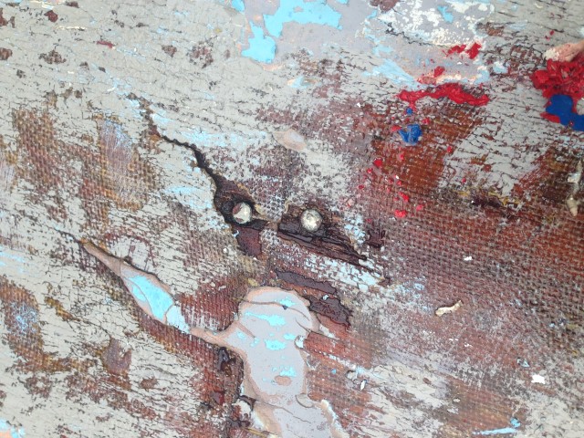

The picture showing the transom? looks like there's exposed plywood in that big gash. You may ultimately need to determine whether there's water collected in it (and therefore rot or dry rot). Unfortunately the chance of that is "good". Minor dry rot can sometimes be treated with the SystemThree "RotFix" kit, but sometimes cutting out one layer of fiberglass, getting the wood out, and replacing it is the only workable solution. You can sometimes glue the fiberglass skin back on, instead of doing a full laminate. Your mileage may vary.

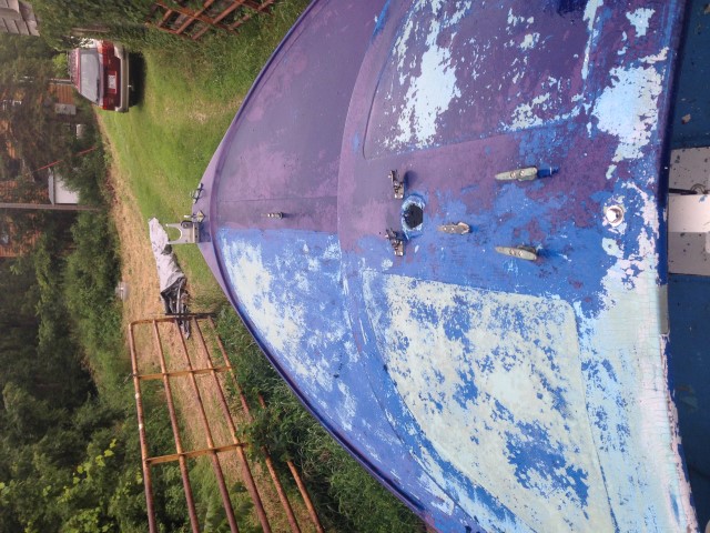

Pressure washing the flakey paint didn't do much, so I got impatient and tried out CitriStrip on the left side of my deck/cockpit. Don't think I put it on thick or long enough, so I only got a partial strip. Here's the deck:

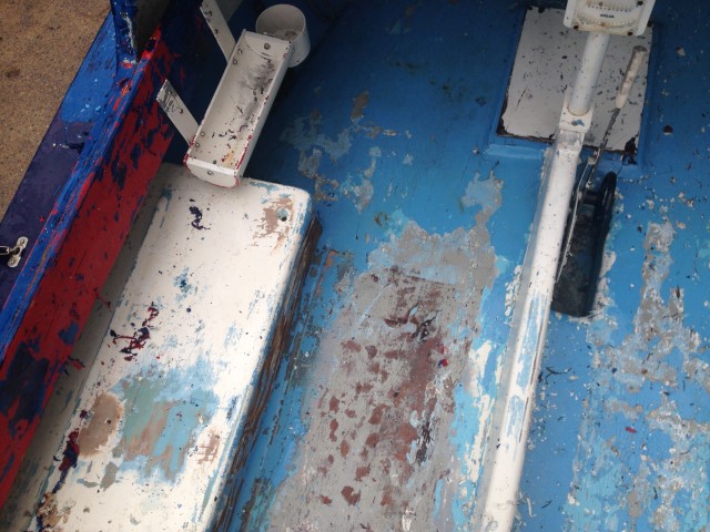

And then I found some nice little presents on my floor, which I believe we assumed wasn't gelcoated but just paint over fiberglass and wood (remember, this is a Sailstar, not a Daysailer.)
whats this (Small).JPG (154.5 KiB) Viewed 1171283 times
There are a couple spots like this where the wood is clearly showing on the floor of the cockpit. This is the only one that has nails(?) in it, some kind of repair I assume?
So now I'm wondering if I've really bitten off more than (I want to) chew right now. I would still prefer to continue with the stripping for the deck/cockpit and then repaint those for this season, and then come back to these problem parts in the winter to do more in-depth repairs. Is it okay to just let all this dry and then repaint it for now?

Postby GreenLake » Mon Jul 22, 2019 12:19 am
You could either do nothing, on the theory that a few months may not make those problem spots much worse, or if you are worried that you''ve opened up ways for water to seep deeper into the structure, you could slap some house paint over it in an attempt to give a bit of a seal. Something easy to remove when you are getting ready to dig out these problem spots.
I believe you have a double hull, or at least a separate cockpit floor, and the wood could be a support (your closeups don't allow identification of where in the boat you found this). Looks like you may need to open up that floor and have a good look and close it up again after repairs. (Requires laminating a flat sheet on your workbench and then gluing that in over the opening (which hopefully goes back to solid laminate on the sides). No way to do wet-layup in place unless you have support underneath.).
