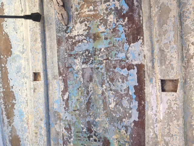

Postby GreenLake » Fri Mar 01, 2019 3:41 pm
Where did you locate this?
It's a bit hard to tell from your photo.

Postby Relentless » Sat Mar 02, 2019 11:04 am
I cut 2 holes like this on the floor of the boat.
The starboard and port Side
One between the rear of the center board trunk and the stern and one at the front of the center board.
I will load some more pics

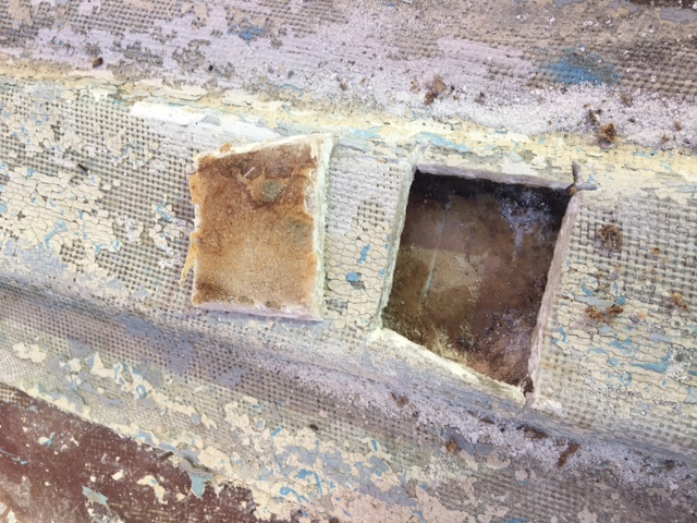

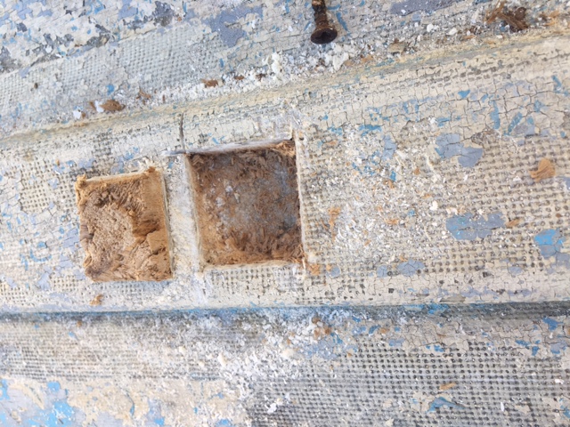

Postby Relentless » Sat Mar 02, 2019 11:25 am
Here is better pics
Port side is good and starboat core material gone.
I am doing so much to boat that next year I will redo both. I am prioritizing because I want to go sailing instead of working on a boat all summer. : )
Starboard side core material gone

Postby GreenLake » Sat Mar 02, 2019 1:47 pm
OK, those are the stringers. Now it is possible to see.
