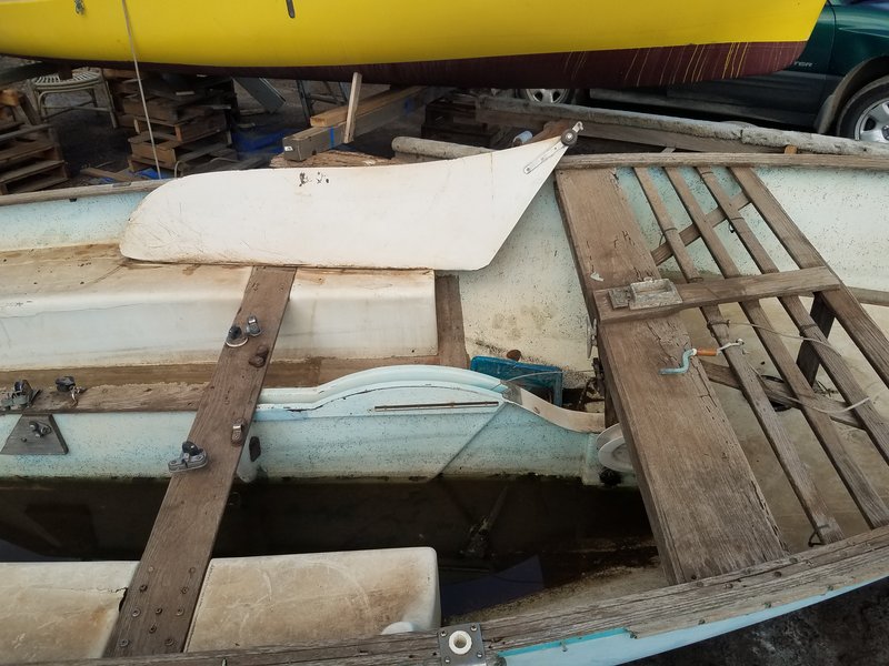

Pic below of the Thistle CB.
The Thistle CB has no pin, and no pin-hole in trunk. Instead it has rollers on the pointy end of the CB, which roll on the curved trunk top. Tackle assisted fore and aft rolling raises and lowers the board.
I like the Thistle CB system. I like its looks. I've always admired Thistles. I was about to acquire this very Thistle. That could be why I convinced myself it would be just as easy to simply transplant the entire Thistle trunk with CB into my yellow boat. No need to modify the Thistle board!! Hence the whole job would probably even be easier!!! I came to my senses, after a little while.
To make the Thistle CB fit my yellow sloop, I will cut some off that pointy end and shape that end to match my trunk. Then it will be 51" X 13.5". Close enough for me. Saint Rudy's new DS boards are 50" X 14.5" . They weigh 51-55 pounds.
This Thistle board weighs in at 73 pounds. It's heavy. It will weigh a bit less after the pointy end is trimmed. A square hole fitting for it is being fabricated in stainless steel. A square tube was welded up today. It is a snug fit on the old bronze handle's slightly worn square lug. Flanges will be welded to the square tube. Pics later. Baby zincs shall be embedded in the board near the SS.

Before you commit to a lifting system, please read all (and I mean all :) ) the long threads about the DS2...
Here's the lifting system you want: Near the top of the trunk, put an axle though the trunk on which you can wind up 4 or 5mm Dyneema (such as Amsteel).That's your lifting "wire". On the outside, of the same axle, you mount a drum, big enough to give you a good ratio of inner/outer radius. 6-8" should do, or even a bit less given the lightweight board. On that you wrap some nice grippy line. As you pull on the outer line, the inner line gets wound up on the axle and lifts the CB with some mechanical advantage over straight pull.
Since you are already overweight compared to class rules, put a bit of lead in the tip to bring the board to 70+ pounds again. That is probably enough to keep it down, so you don't need a downhaul.
You do not want chain - it would kink into a mess inside the trunk and wedge itself god knows where.
You don't want to copy the DS2 system - every owner is unhappy with it :)
So, go with the system I've tried to describe (it's used on the O'Day mariner - that CB is bigger, but also much heavier yet, so I know you won't have trouble raising a lighter board with it. As long as the board is heavy enough to stay down when you go fast, you don't need a downhaul (one less line to get wedged).
If you go for this, don't overdo the mechanical advantage. Figure out what's comfortable to pull when making an adjustment underway, and go from there.

Another project ! ? Well, OK, good point, I will use Amsteel instead of chain. Thanks! But initially I will try brute force instead of the proven, sensible efficient axle and drum you described. It is just that time is running out over here. The yard (and others) are being evicted by the state, as parking is needed for increasing numbers of shipping containers. Axle and drum later, if needed. Someone else said just leave the "!%#**@X&$" board down. But I want to be able to raise it.
Pics:
Blue tape indicating, (like a blueprint?) (sorry) the 1st rough cut of Thistle CB. The SS square tube is there too.
Pointy end with rollers cut off, revealing lightweight foam core construction of CB head area. It would need major reinforcement if the square hole is to be used to raise the board. Not gonna happen. Too heavy for the fittings and CB head, I think. The hole and handle will now serve as pivot only. Even that requires reinforcement.
For reinforcing the square, maybe insert a 6" (or bigger) plywood disc or square, epoxy/glassed, with the SS square mounted in it ? Or maybe just a glass & epoxy insert would be better, instead of plywood ? Thickness cannot increase so the insert needs to be edge joined, or maybe 'scarfed in' ? I need to talk to a 'foam joinery' expert.
