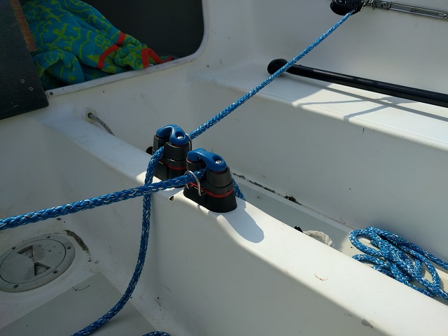

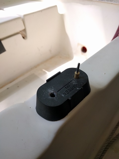

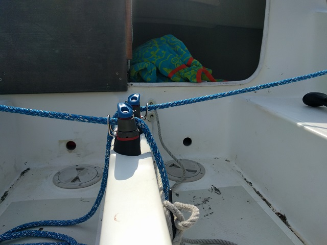

I have installed cleats on centerboard trunk on a Daysailer II.
DigitalMechanic has a thread titled "Mainsheet setup and Purchase System" in which he and the late great John Alesch (JeadSTX) concluded you could go about 0.75 inches into the trunk without interfering with the centerboard. I didn't go quite this deep, probably closer to 0.5 inches. No problems.
When I did the install, I decided to use Harken wire fairleads and angle blocks with H150 cam cleats. I replaced the cleats on the jib cars with Harken 57mm Carbo Ratchematic automatic ratchet blocks based on reports of people finding the holding power with the smaller size inadequate. You get barely 90* worth of wrap around those blocks, so you won't see near their max potential holding power. I chose the auto version because I didn't want to be trying to go forward or to the leeward side to change settings while single handing.
It needs to be noted that the Harken angle blocks and the centerboard trunk are not the same angle. This meant that I could not simply drill a vertical hole. To ensure I got things right I made a small brass bushing on a lathe and used it to guide the drill. If you are very accomplished at drilling things by hand you could just send it. I'm not, so I didn't.
I threaded fiberglass itself and ran #10 machine screws in with 3M 4200 and hoped for the best. So far so good.

Postby DigitalMechanic » Mon Jan 15, 2018 8:52 pm
Curios question? Why did you level off the cleats with those spacers. I like the fairlead pointing down, and the back of the cleat elevated. I feel it makes it easier to cleat off sheet, especially when hiking out. I am pretty confident that O'Day designed the the 2 angled sections on the DSII centerboard trunk with that in mind, to angle the fairlead down, making it easier to pin the sheet from various sitting positions. What is your opinion of having the cleats level after sailing it some?

Postby badnews » Tue Jan 16, 2018 12:29 am
Before settling on this course of action I mocked up the install several ways. All tests were conducted while sitting on the rail as if hiking out. I believe you use bullseye fairleads placed in front of the cleats. I had bullseyes so I did experiment with that setup. I felt it was going to be awkward to play the sheet by hand and too easy to accidentally cleat the line. I also wasn't entirely happy with how high or low I was going to have to reach to cleat and uncleat with any of the combinations I could work up without the angled spacers. With this solution the cleat is still angled away from the windward rail, just not as much. In practice it worked out really well - the angle is about spot on. It's easy to cleat and uncleat the sheet, but also possible to play it by hand with a very natural motion. If I had to do this over again, I would do the same thing.
I think there's a variety of valid solutions, and the best one is probably determined as much by the physical size and shape of the captain or crew as anything else.

Postby GreenLake » Tue Jan 16, 2018 2:49 pm
@badnews - thanks for sharing your setup. I'm curious to see that you have both the wire loop and the "bridge" across your cleats. I would have thought one of these to be redundant, but perhaps there's a subtle difference. It seems that the wire loop brings the sheet down in a way that better mimics a fairlead ahead of the cleat. Perhaps that's the reason why you don't see the same benefit of angling the cleats so that they "aim" at the level of the jib sheet tracks.
As you know, I have neither wire nor bridge on mine and aligning them with the jib track is needed to make sure the sheet is cleated securely. At times, the aid of a foot is needed to deflect the pull downward to cleat if I'm sitting on the gunwale. However, as you point out, conditions are different. We have enough days of light winds where I may be sailing the DS from the leeward side and then having open cleats is really much more convenient.
Re: Putting cleats on the CB trunk
Postby badnews » Tue Jan 16, 2018 4:32 pm
Hey Greenlake, they do serve somewhat different purposes.
In general, cam cleats will tolerate a fair amount of horizontal misalignment and some lesser degree of vertical misalignment. In this application, as the cleat and the block on the jib car are at different heights and not on the same plane, the sheet always enters the cleat at an angle. Additionally, adjustments to the jib cars cause the horizontal alignment to vary, although this is somewhat less critical. The wire fairleads on the load side direct the sheet into the cleat with as little misalignment as possible. You can see the sheet does change angle in the picture as it passes through. This is more noticeable under load - when the sheet is pulled taught the ratchet block can swing up higher and the change in angle becomes a bit more pronounced. Honestly, with the low loads on the sheet (there's what, 50 square feet of jib out there?) and the surplus holding power of the H150 cleat and decent sized line, this is largely unnecessary. Additionally, they aren't particularly rigid. If the sheet was under such load that the slight misalignment was testing the holding power of the cleat, they would probably just flex and deflect. However they are inexpensive and have some small benefit, and as I already had them (I ordered a variety of hardware and fittings for this project) I installed them.
The plastic fairleads on top of the cleats have no effect on the load side. They are meant to help guide the line into the cleat on the trim side. With them in place it is possible to cleat the line at a fairly significant angle - say from the stern of the boat. They also prevent the sheet from coming completely clear of the cleat (not really an issue in this case as the wire fairleads would prevent this anyway).
With this setup, there is no need for any karate foot action as all angles and leads were selected to make the jib sheets as easy to cleat, uncleat, and trim as possible for a 5' 5" female sitting on the rail. My 6' limbs can make do either way, but the sheets cleat at somewhere around waist level and uncleat below shoulder level - an easy reach for about anyone. I didn't want anyone to have to take their feet out of the hiking straps (still yet to be installed of course... :roll: ) or lean down into the boat to cleat off. During rigging the sheets are pulled through the fairleads and cleats and a stopper knot is tied (they're quite long). If the need arises to blow the sheets they can be yanked upwards and allowed to run or even thrown into the center of the boat with no chance of losing them. The issues with the original jib car mounted cleats are pretty well known and have been discussed in a number of places on the forum, but it was immediately evident that if the breeze was up it took pretty significant muscle to uncleat the sheet. It would often become tightly wedged and acrobatics would ensue. One user's comment about how an inability to blow the jib preceded nearly every Daysailer capsize he had seen made a lot of sense to me. There was also so much drag coming through the bullseyes on the original jib cars that the crew often had to really fight to sheet in the last 6-12" after a tack.
