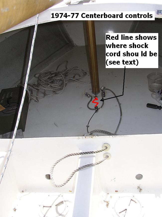

Nice idea. If you put a bungee around the mast step in the cuddy to keep tension on the UH when the board is deployed, there shouldn't be any more jamming problems, but the double line is an elegant backup.
FYI, the "standard" rebuild (standard meaning, what D&R Marine sells) is two steel cables (UH and DH) that are mounted slightly offset on the edge of the board so that they pass each other on the top forward corner of the CB. The old rope that came out of the top of the board isn't used, and the hole where it was installed is filled in with epoxy putty.
Let us know what you figure out for the DH shock absorber. Another approach is to anchor the end of the DH line to a breakaway Clam Cleat in the cockpit. But your elastic idea might be better. As a former skier who spent lots of time falling and twisting out of bindings, I know that any slop between the force and the binding make release unpredictable. And there is a lot of slop in the DH version you have (stretch in the line, friction in the purchase system) before the line ever gets to its cleat. Some DS owners actually retrofit their control lines to an older version where the DH cable comes directly into the cockpit out of the top of the CB trunk. That allows a shock cord (pictured earlier in this thread) or release cleat to be attached almost directly to the board.

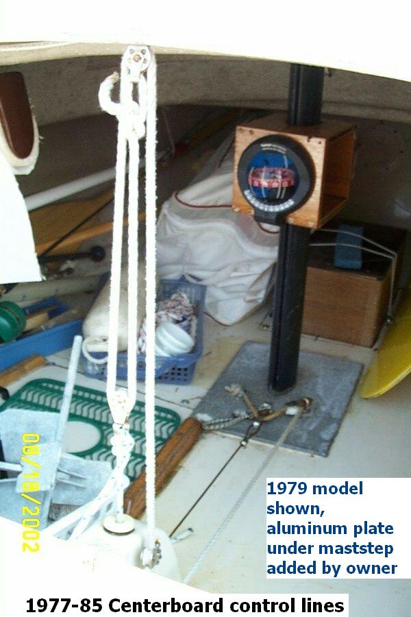

1977-1985 setup (1979 model shown)

1974-76 setup (actually includes some 1977 models)
1975_CB controls.jpg (72.23 KiB) Viewed 8778 times

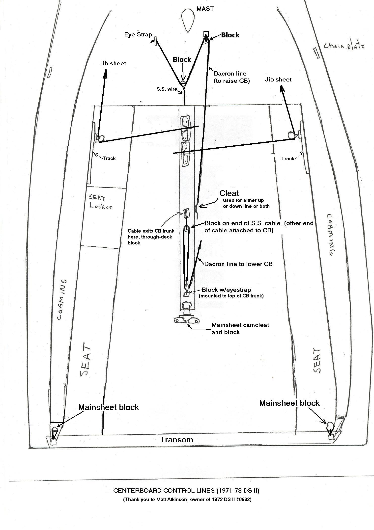

Cockpit drawing of 1971-74 setup
The DS II centerboard rigging was changed twice during the 1971 to 1985 production run (that I know of, Rudy Nickerson at D&R originally only knew of 2 versions until I found evidence of a third).
Original, 1971-sometime in 1974, 1974-october 1976, and October 1976 to 1985.
Some owners of boats with the original setup have had luck attaching a length of stainless-steel sail track to the forward (with CB up) edge of the CB (top if CB all the way down) this will tend to contain the cable and stop it from slipping off the edge and jamming between CB and trunk side. My boat is a later model with the 5/16" rope to pull CB down (actually, I replaced with 1/4" double-braid since that was what I had. Works fine).
