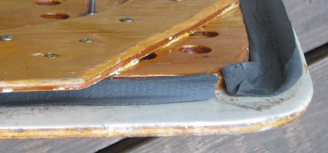

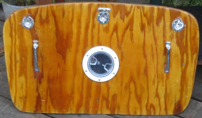

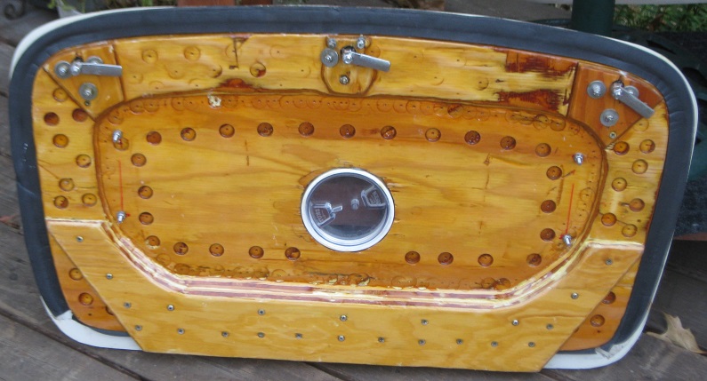

Sure. Here are the pix. Know that:
1. This was supposed to be a prototype. Six or seven years ago. Maybe I'll get around to making the "real" hatch one day.
2. I used marine plywood from Lowe's. Since then, local boat hobbyists have told me the wood is obviously fir, and not what a real boatbuilder would use. Apparently the only professional grade marine plywood on the west coast comes from a single plant in Tacoma, WA. The locals said that for a hatch, I might get better results from using top-grade exterior construction plywood. (After all, the hatch doesn't have any more water contact that the shutters on a house. At least, as long as boat is right side up.)
3. I varnished the hatch originally. Now I would use West epoxy with its clear hardener. Then varnish over for UV protection.
4. The hatch itself is 1/4" thick and the rim that fits inside the cuddy opening is 1/2", and there is an extra piece supporting each of the three dogs, plus another flange that fits over the bottom lip of the opening, making the whole monster unreasonably heavy. Note the pathetic lightening holes drilled in the inner surface.
5. The lower corner is a weak point. The bulkhead is somewhat convex, so the hatch is tight on top, but springs away from the bulkhead at the bottom. Hence that big lip. Note the small photo of the corner. The hatch tape goes from sealing the inside surface of the hatch to sealing the bottom surface of the rim. I have not found a way to do that transition and make it last all summer. You can see that the upper piece of tape has torn away from the joint, leaving an unsealed space.
6. The latches come from Marine Parts Depot. They turn to fasten against small oak blocks inside the bulkhead. Those are held in place with glue and the same screws that anchor my Barber lead cleats (see earlier cockpit picture). Speaking of which, the things hanging on the hatch in that photo are a solar charger (removed when underway) and the bag that holds my halyard tails.
7. I think a better way to make a hatch would be to bend a thin sheet of plywood to the exact profile of the bulkhead, then reinforce it with strategically placed hardwood strips, avoiding the massive thickness of the inner rim. Add two more latches on the lower surface. Use a continuous foam tape on the inside surface, joining the ends with silicone. Factory hatches on newer Day Sailers hinge at the top, but I wanted to be able to take the thing completely off in gentle weather when we don't need it.

Postby ChrisB » Thu Oct 01, 2015 3:01 pm
Lightweight, perhaps not but definitely well constructed. In the cockpit photo from your earlier post, there are what look to be four bolt heads on either side of the hatch. They are arranged in a more or less vertical pattern on the cuddy bulkhead. Are these related to the hatch or something else?

Postby talbot » Thu Oct 01, 2015 4:30 pm
Ah, yes. My 1973 Day Sailer II looks like it was itself a mockup for a boat that O'Day hadn't quite finished planning. The bulkhead was poorly finished, and it was not only curved, but curved differently on either side of the cuddy opening. I took two oak strips, put them on edge, and bolted them to either side of the opening, forcing the bulkhead as flat as possible without cracking the fiberglass. I did that before I measured for the hatch.
Basically, any time I mount anything on this boat that requires a flat surface (inspection ports, compass, etc.) I have to shim and/or shape to complete the job. And any paired features (e.g., port and starboard thwarts, port and starboard running light openings) have to be independently measured and cut for each side, because nothing on the boat is symmetrical. I should have named the boat "Learning Experience," or maybe "Object Lesson."
