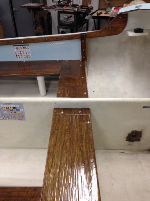

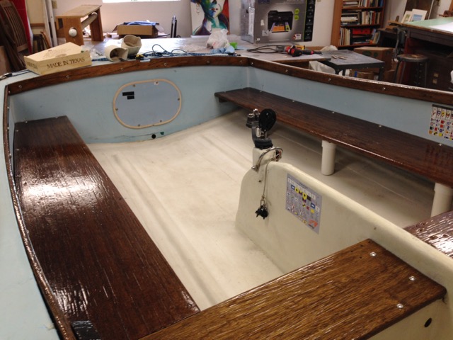

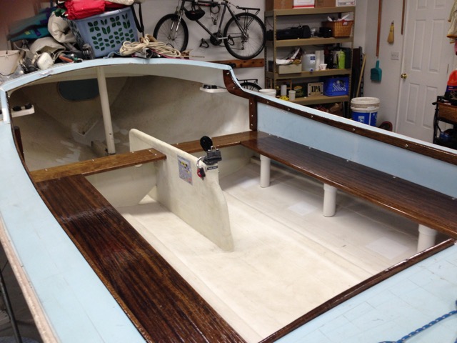

Not quite finished (still need to re-install fittings), but here are some photos:
This one offers a view of the solution I chose for supporting the bench seats, short sections of 2" PVC pipe bevel cut on the bottom (but not attached in any way to cockpit deck) with the tops inserted into flat-topped PVC caps that are screwed into short sections of 1 X 4 pine (also epoxy encapsulated) fastened to the underside of the mahogany bench running perpendicular to the bench length (sorry, I should have taken some detail photos before I re-installed). I added these to spread the load out a bit. Not as aesthetically pleasing as wood, but inexpensive, and I don't think they look too bad. In this shot you can also get a glimpse of the newly painted (with three coats of latex flat exterior house paint) underside of cabin top.
Interestingly, once I began adding coats of epoxy and then the urethane topcoat, I saw how different the thwarts looked compared with the benches. When they were all weathered and faded, they looked more or less identical.
Only a few blemishes/mistakes here and there. Finding, here and there, a sheared off end of one of the old brass wood screws in some of the gusset holes (front end of each bench is gusseted to thwart with a 9" square of marine ply--now also epoxy encapsulated--screwed into underside of each), I carefully tried to drill each out to allow for the new fasteners. on one of these the bit popped through to the topside of the bench. I filled that with epoxy mixed with a bit of sawdust and will put another few coats of the topcoat over this patch. Other than these, the only other blemishes are one or two very small spots on one bench and one coaming section where the epoxy seemed to turn a bit "cloudy." Not sure what caused this, but you have to look pretty hard to even notice them.
I still have to finish the installation of the centerboard and, as I said, re-attach the various fittings, but we hope to be sailing again within a couple of weeks.
Let me know if you would like me to post any more detailed photos.
