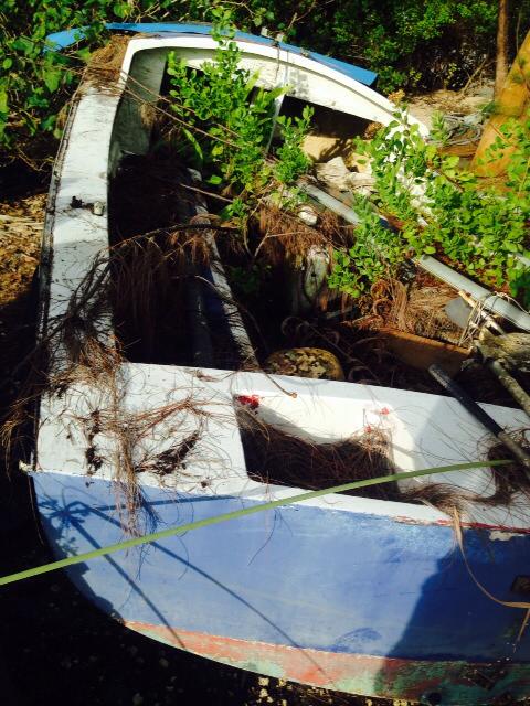

"Before"

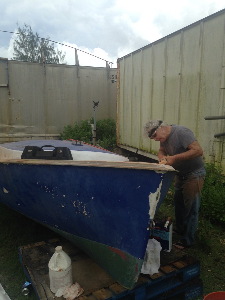

Hi All, I am a member of the Marianas Yacht Club in Guam. We pulled a boat out of the swamp and believe it to be a Daysailer I. There is no builder plate or any other markings that we have been able to find. All of the wood has rotted away or is missing. We also have no idea how to properly rig it, although we did locate a mast and a managled boom. The centerboard and rudder/tiller both seem serviceable. Everything else will have to be re-done. Check out the before pic I posted above. There are very few sailboats here, so we are hoping to restore this on for use at the club. It is mostly solid, but will need a lot of work. It probably wouldn't be worth it to attempt this for most people, but it's expensive to import boats here. Currently, we only have lasers and optis, nothing for families to sail together at the club and we have big plans for our little daysailer.
We have gotten out all the plants, and most of the sand. The first step is to replace the thwart to stabilize the centerboard trunk, and to rebuild the transom. We also need to fiberglass a few places of the flotation tanks/seats where they have seperated from the hull. Any advice would be great on these, or other issues that you can see Check out my blog of the first couple work party days for more pictures and information:
http://www.wheretheheckisguam.com/categ ... ation-myc/

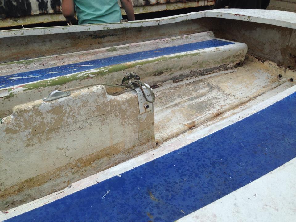

Here is a few recent ones with stuff cleaned out:
cockpit center.jpg (110.47 KiB) Viewed 22961 times

The CB seems to have a control line exiting the top of the trunk. I have not seen this mentioned in any of the discussions on this forum. Wonder whether that is a retrofit...

Thanks for all the help! I knew that the cuddy was a modification, but I didn't relaize that the CB control line was not original. It seems to work well, on land. Has anyone seen this before?

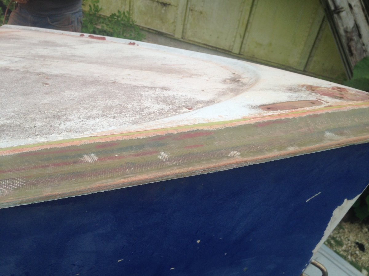

Postby GuamJulia » Thu Oct 30, 2014 7:36 pm
Hi All -
Thanks for all of the help so far. The yacht club APPROVED the project, and we have been moving forward. It's been slow going as this is our rainy season, but we have removed all the broken pieces and have begun reinforcing the hull deck joint. One of our volunteers is planning to screw a thick piece of line all the way around to act as a bumper, as this will be a trainer boat.
It appears the hull deck joint is stapled together? Do you guys have this?
We still have no clue what year this boat is, any ideas would be great.
Also, does anyone have a pattern for the seat? I have been unable to find actual measurements to go on. Ours is completely gone.
Also, Does anyone have any close up photos of the original arrangement of the carlins that support the side decks?
Thanks in advance!
Julia

Postby GreenLake » Thu Oct 30, 2014 8:03 pm
GuamJulia wrote: Thanks for all of the help so far. The yacht club APPROVED the project, and we have been moving forward. It's been slow going as this is our rainy season, but we have removed all the broken pieces and have begun reinforcing the hull deck joint. One of our volunteers is planning to screw a thick piece of line all the way around to act as a bumper, as this will be a trainer boat.
The original had plastic rub-rail, for the same purpose. Sounds like a plan.
Can't say. The actual joint is hidden under the rub-rail on the outside and from the inside, some previous owner applied a layer of glass for extra strength. I'd go for the glass (at least in the foredeck area).

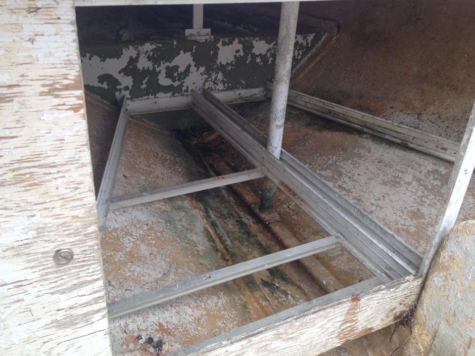

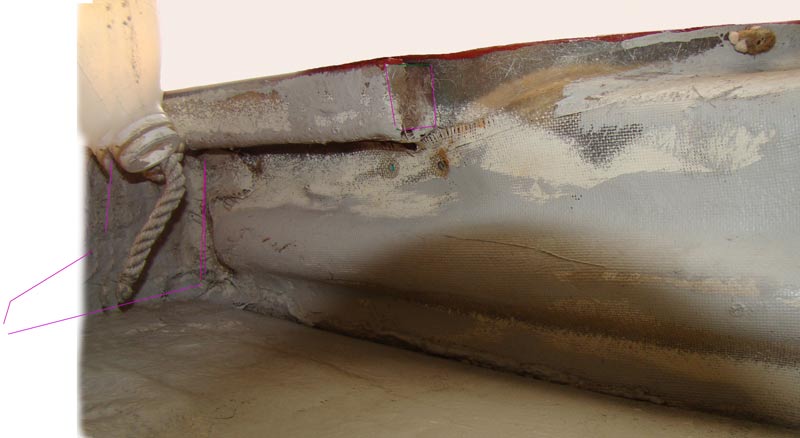

Here's a photo that happens to show carlins and knees.
It's taken from in front of the seat bench, the camera pointing upward. The bow is to the right.
You can see
1) the forward end of the carlin, and the pathetic attempt at wrapping it in glass. I've outlined the end.
2) the first knee. Outlined.
3) a hollow stringer supporting the side deck in front past where the carlin ends. (You can see the rear end of it, and the horizontal line of shadow where it extends forward, about 1" inside the hull.
View showing the underside of the side deck in front of the seats, front is left.
That's the best I can do.

Postby jeadstx » Thu Oct 30, 2014 8:50 pm
The hull and deck were stapled together, but there was also a rail for the rubber rub rail to attach to stapled with it. If you go to the D& R Marine site you can see a picture of the rail and bumper for reference.

The main concern is that while the line pulls the centerboard up just fine, there is nothing to pull/push it down, or hold it there. We are hoping the weight of if will hold it down, but this seems a little sketchy. Hopefully it will be clear once we get it in the water.

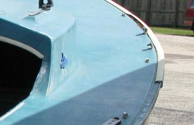

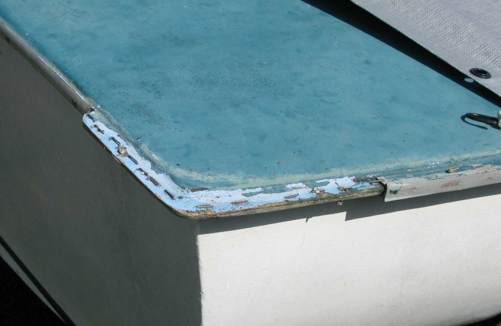

Attached are a couple pictures of a O'Day Rhodes 19 hull/deck joint showing the staples. The Rhodes 19 and the Day Sailer I hull/deck joints are the same. One picture shows where the rail for the rub rail is missing along with the rail in place. The secong picture shows the rub rail and how it attaches to the rail along the hull/deck joint. The rub rail is suppose to go all around the boat, one continuous piece from the stern around the bow and back to the stern. My Rhodes 19 had most of the rub rail missing, but provides a good illustration of how it goes together. D&R Marine sells both the rail that goes over the hull/deck joint and the rub rail.
Rail - Staples for Hull joint. Staple go thru rail as well as hull/deck joint.
Rail - Staples for Hull Joint.jpg (96.7 KiB) Viewed 22575 times
Rub Rail in place shown with attachment rail exposed.
Rub Rail - Rail.JPG (18.86 KiB) Viewed 22575 times
