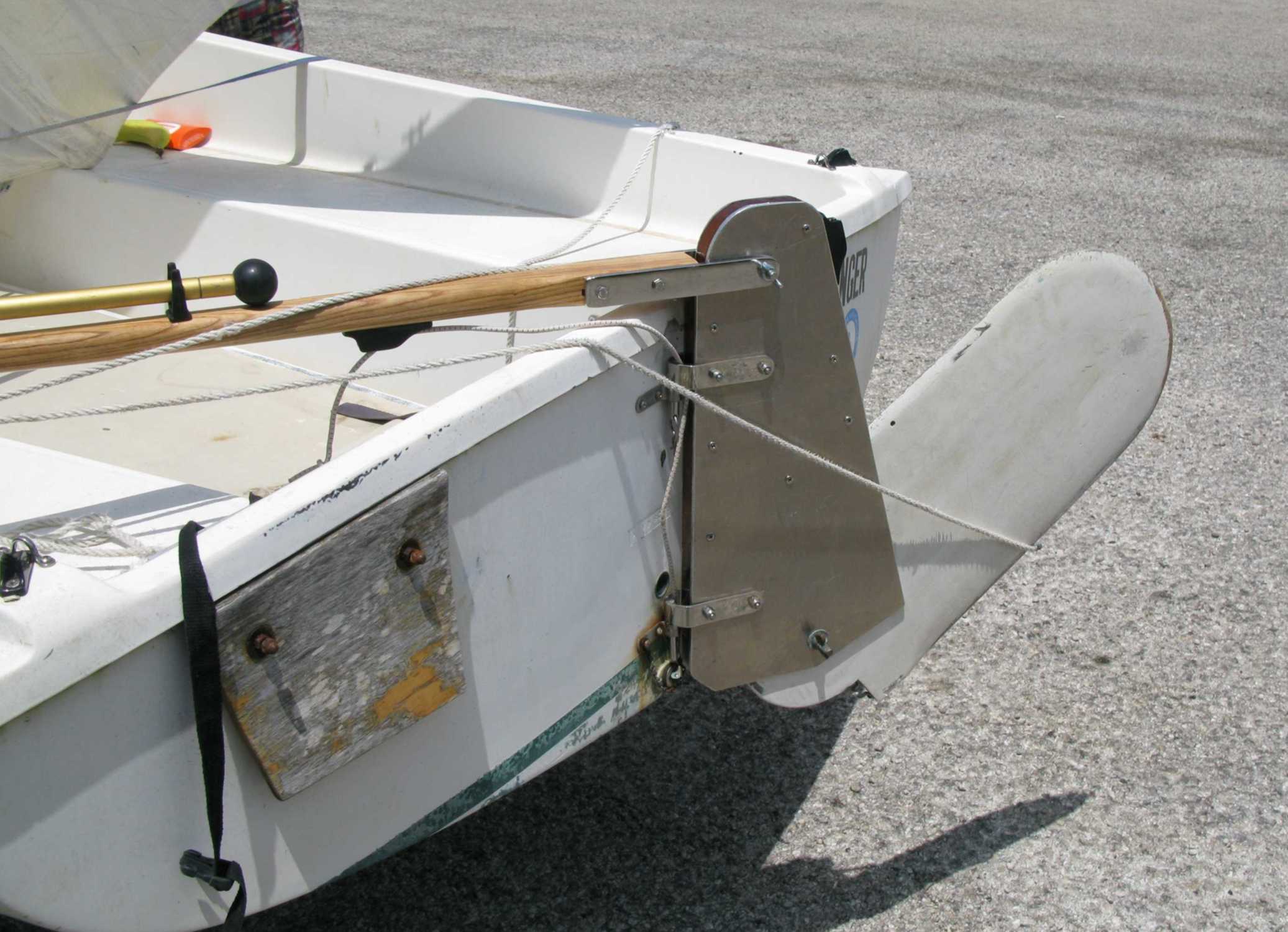

I made a new rudder head for my boat to allow the blade to come most of the way out of the water while beaching on the Tx200. During the 2011 Tx200 the blade got jammed while pushing off a beach and the rudder head cracked below the tiller attachment point. Someone with a portable drill was able to drill a hole below the crack to re-attach the tiller. The tiller was at about a 30 degree angle for the next four days of sailing. As a result I made a new rudder head that would allow the blade to raise up out of the water when beached to prevent a repeat of the 2011 problem. I aatached an UH line with a clamcleat with fairlead at the top of the rudder head. I used a clam cleat with fairlead for the DH. I used shock cord with the DH, but plan to switch to an auto release cleat like Tim is using. The new rudder head also allows boat to be launched and retreived with the rudder in place.

UH was not yet attached when the picture was taken, but you can see the cleat and a hole in the blade.
