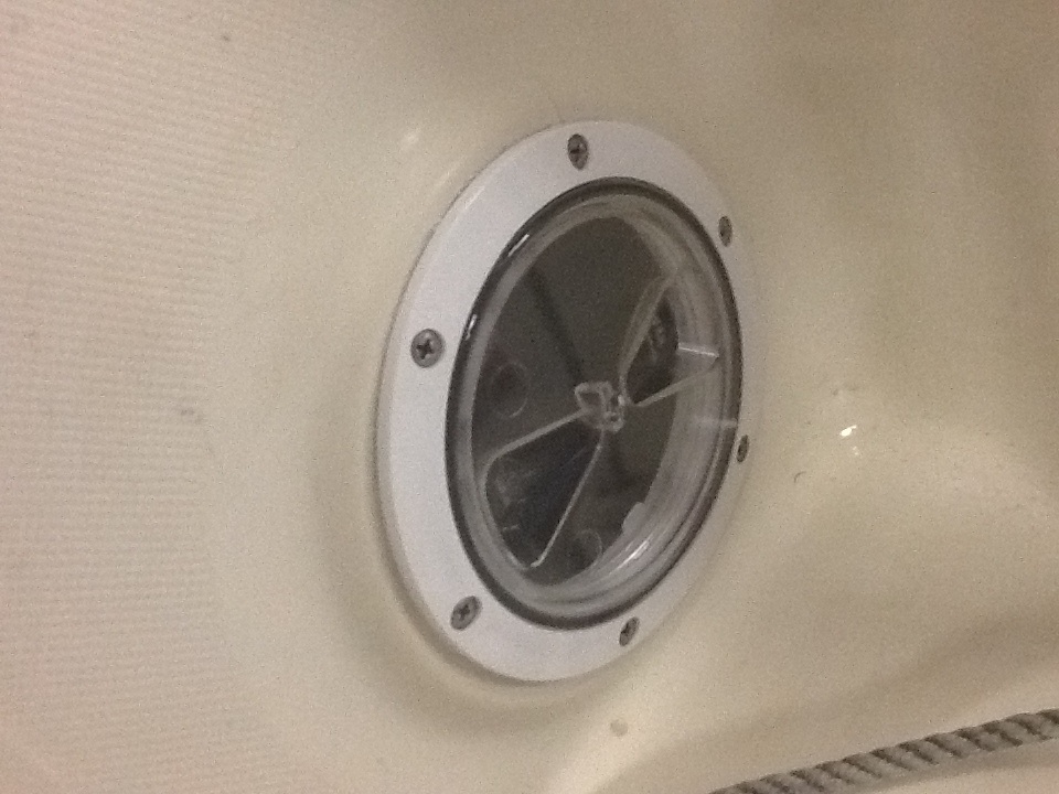

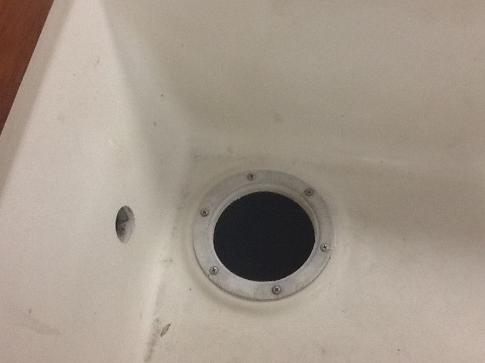

Postby Thomasjbrothersjr » Sun Jul 28, 2013 7:00 pm
They're in... One of my easier upgrades. This was made easier by sheer luck, the two sets of holes lined up. I removed the old brittle bases, scraped and cleaned the surfaces and made sure the holes were large enough to accept the new hardware. I used stainless steel machine screws, stainless washers and stainless nuts with nylon inserts. I ran a bead of Marine Silicone adhesive around the back of the plate as well as filling the drilled holes. It is funny how you forget how much of a pain in the ass the silicone can be. After tightening the 6 screws down a small amount squeezed out from beneath it...perfect. A little clean up and we're done.
New plate
Old plate
Thomasjbrothersjr

Great pics Tom, thanks for including them. The install looks great. Your before pics look just like mine, gray and crumbling.
DSII Smitten
