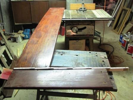

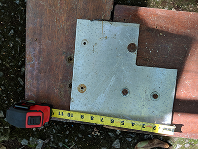

I have an a DS with wood seats and thwarts. They were joined by a door hinge type bracket that does not seem to be something that would be original. I have removed the seats as they have become too springy and am replacing them with new boards. Attached are some pics of the seat & thwart.
My question is how did O'Day originally join them together? Also as the seats are too springy (fell they are about to fail) do some some owners put in intermediate post supports for the seats?

Few of us have a DS1 of that vintage and not many have even seen one. That said, we still might be able to give you some general suggestions. From the photo, I find it hare to picture who these boards were positioned in the boat. Is the configuration such that the thwarts go from CB to the side of the hull, and the seats extend aft of the thwarts only? That would be on contrast to the later design, where the fiberglass seat (tanks) extend forward of the thwarts and the latter only extend between the seat edge and CB.
If I understand your configuration correctly the sideways forces from the thwart go directly to a hull bracket. The connection to the seat (helps ?) support the seat (I assume there's some 'leg' below the seat to take most of the weight, but from what you show us here we don't know where it's positioned fore-and-aft.
The hole pattern you show in the picture (alternating) would match that of a hinge. There's no need to have that connection actually be able to flex, I think, so the hinge may have merely been a convenient way of doing a repair. I don't see why you couldn't replace it by a suitable wooden backing, like a piece of 3/4" plywood (nicely stained and coated in epoxy on all 6 sides and in any drilled hole - see earlier posts here about that).
You write that the seats are "springy". Is the wood affected by rot, or are they just undersized a bit (and / or possibly lacking the seat supports I was speculating about before). Unless there's rot, I don't think that wood becomes "springy" as result of age.
Do you find any indication, other than the hinge, that the entire set of seats/thwarts had ever been rebuilt before?

But it appears that there is no connection between seat and thwarts and that the seat supports are spaced so that the front end of the seat can sag. This makes it very likely that a PO tried to remedy the issue and found a hinge suitable for his purpose.
If the wood for your seat benches isn't actually damaged, but only undersized, I might consider gluing a strip of wood 3/4" x 2" under the inside edge (a bit recessed so it's not visible from across). I think you will find that this will nicely stiffen the seat (as the bending strength rapidly goes up with the thickness, the strip does not have to be all that wide). Same recommendation to seal with epoxy on all six sides after staining to match. (Water-based stains are preferred for use below epoxy).
If the seats are in reasonable shape other than being to flexible, this might be a cheaper/easier fix.
