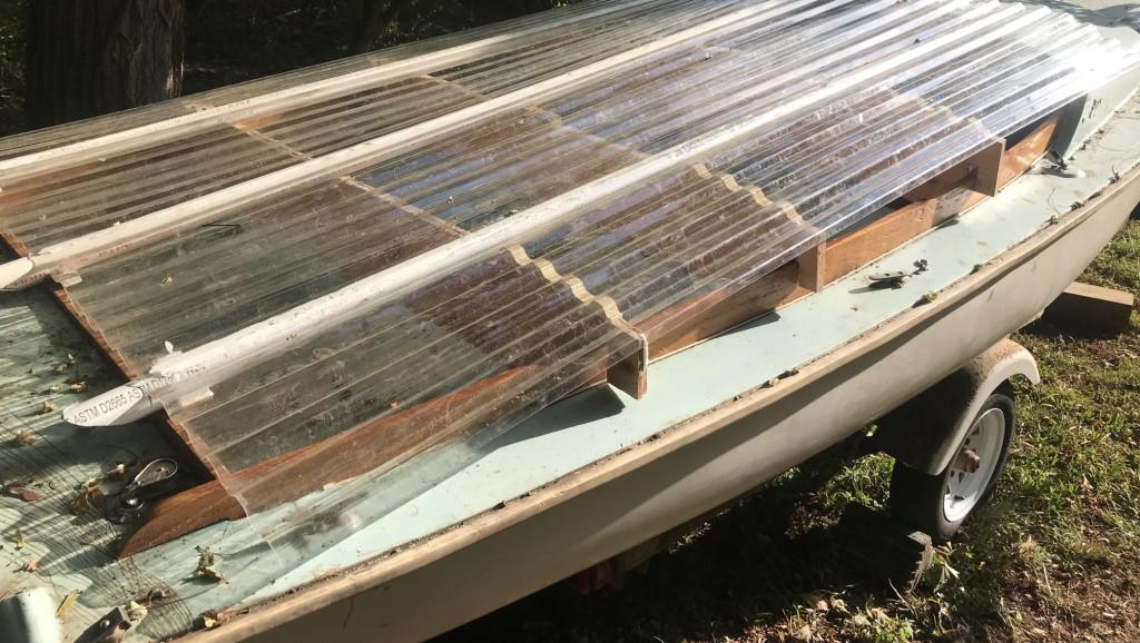

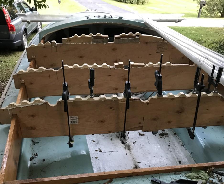

It took a long time to build a removable cover that uses no fasteners. I used 1/2 inch plywood and glued two pieces together for three cross ribs. It took a lot of incremental adjustment to get the final shape for each of the three cross ribs. They stated as identical and are now unique about 22 inches apart.
For the fore and aft I used three polycarbonate panels (8 feet by 29 inches), each with a 1.5 inch PVC pipe glued into the underside near the middle. I had hoped that these panels would be identical but found that I needed to put a small piece of PVC lumber on each end of the PVC pipe to keep the panel and pipe from sliding off, especially as I was trying to make the contour for the top of each rib. It turns out that the8 foot length of the polycarbonate panels is barely enough to cover the cockpit. I stretched a 5x7 cheap plastic tarp over the cover to give better wind protection and keep the leaves out.
I have tried to attach pictures of the rib frames and the polycarbonate cover. It looks like there are two copies of one of the pictures. I apologize. (fixed it for you ~GL)

Interesting setup. I have one place I sometimes store my DS where there's not enough space for leaving the mast horizontal. A system like that might have worked - instead I just "simulate" a mast with some shorter pieces of lumber and use the same tarp as always.
