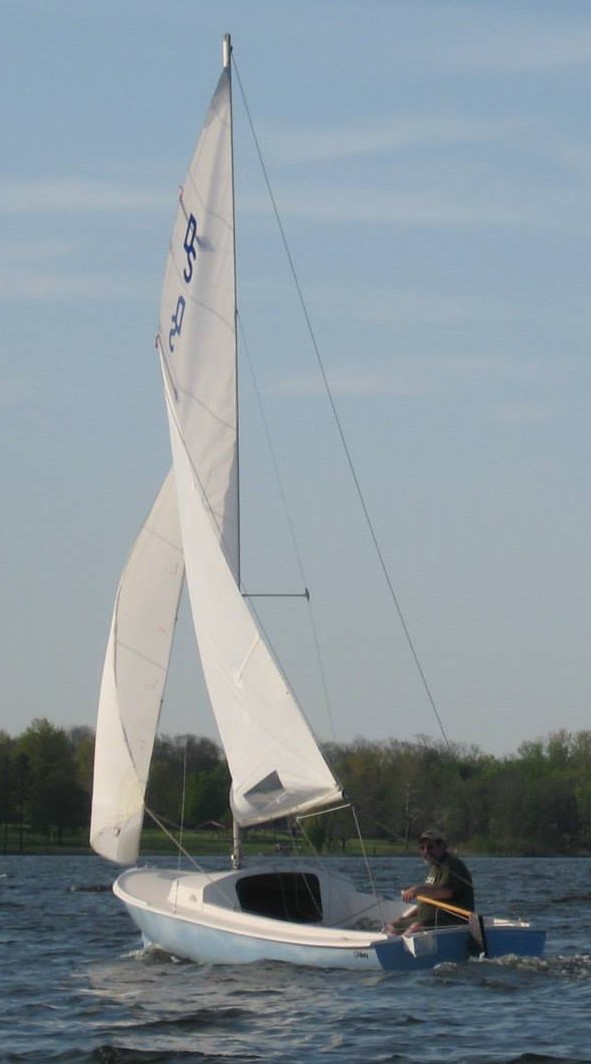

2013 CreekFleeet Sail Club shakedown cruise was sunny,warm, and challenging! Maybe 10 boats? Winds increased from 6 to 10-13 MPH after we all got out. Unfortunately, another Daysailer (a beautiful '65 classic) sailed by an older gentleman and his wife, was demasted (8 O) I did't see it, but heard they got in safely. I was busy hopping around, frantically fixing rigging errors mid sail. After getting the boat back on the trailer, judging from the amount of water coming from a spot in the hull (which seriously looks like it was repaired with Dryloc masonry paint, LOL), I have a little more patching to do. A truly successful shakedown. Ah, 'tis nice to live in Michigan... again!!! :lol:
