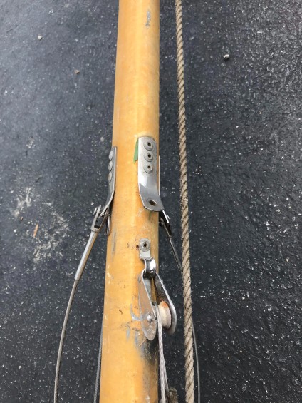

Postby HanksDad » Sun Jul 18, 2021 2:00 pm
See picture below of the pulley the jib 'forestay' runs through - note the empty forestay attachment which is normally used.

Postby jalmeida51 » Sun Jul 18, 2021 4:42 pm
The wire inside your jib is called a luff wire and when the the jib is fully hoisted it becomes your forestay. You need a secondary forestay to hold your mast vertical after stepping it. After stepping the mast the second forestay will be rather loose. The bottom furling drum attaches to the stem head. The top swivel attaches to the jib halyard. You can only furl with this system you can't reef with it.
I owned a Apollo sailboat with this system about 20 years ago. To increase the purchase it had a Harken magic box on the side of the mast and it increased the purchase to at least 6 to 1 on the jib halyard. That got the shrouds and the forestay to the right tension. Harken stopped producing the magic box but Holt Allen makes them. You will need some type of hardware to increase your purchase on your jib halyard if you don't use a system like a magic box. Maybe someone else on the forum has an idea on getting the right tension on your rigging? Just pulling down on the halyard will not get the proper tension on your shrouds and fore stay. ( luff wire )
I did my best to remember how the system worked on the Apollo and I hope it shed some light on your rigging. Many other small dinghies use this system.

Postby jalmeida51 » Sun Jul 18, 2021 7:46 pm
Try this, Step your mast, one person steadies the mast. Cleat off your main halyard, with the other end connect it to trailer winch. Put tension on your halyard with the trailer winch and this should tension up your shrouds. Connect your furling drum to your stem head. Tension up your jib halyard. Release tension from your main halyard and this will give you tension on the shrouds and forestay. (luff wire ) I believe this is how the previous owner didn't have a secondary forestay and tensioned up the shrouds and luff wire without a magic box or some other means.
