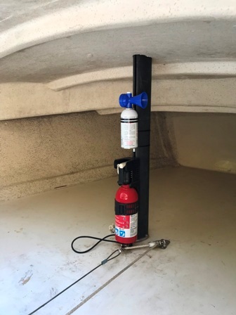

Other than just throwing in coolers and plastic bins, what type of ideas or improvements have you all made to maximize the storage space of the cuddy? I read that the DS1 had trays on either for storage, but the DS2 & 3 just have an open area. Also, would it be OK to drill holes in the cuddy roof reinforcements to add hooks or other attachment hardware? I've also been considering having some cushions made to fit the floor of the cuddy in case my family or I would like to rest inside for any reason.
I started by attaching the fire extinguisher and air horn the lower end of the mast:

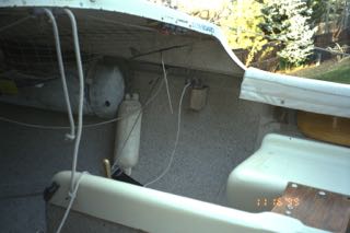

The best system I found for additional storage under the cutty is a net attached under the roof of the cutty with the leading edge of the net is held in with elastic.
The net lets you store things you want to stay dry or if wet then to dry. These things will stay with the boat if the boat capsizes. Been there and done that.

My nets came from a West Marine kind of a store. They there a hammock for the galley to store fruits. I open them up and threaded shock cord on the front.
