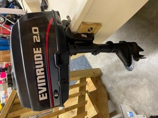

I recently moved and want to sail my DSII from one of to boat ramps. My boat has a 2HP Evinrude outboard motor with a 360 swivel tiller for steering, a throttle control on the front on the motor housing, and no reverse gear.

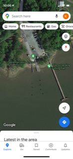

Enclosed marina, small opening to river, 2 lane ramp between road & building on waterfront
2 lane ramp next to fishing pier

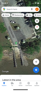

2 lane ramp next to fishing pier (zoomed in)

From your pictures, the magnified boat ramp looks like one I've sailed to occasionally. It's too narrow to approach downwind and do a U-turn at the last moment, but you should be able to approach it upwind, or in a reach (with main down for the latter, and jib sheeted in just enough to get enough momentum). What are typical wind directions or speeds?

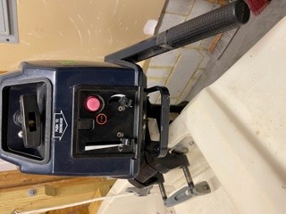

Thanks for the advise. My outboard motor has a kill push button on the motor housing near the throttle lever. It does not have a neutral.

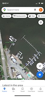

I don't know the prevailing winds on that part of the James River yet. I have not been out on a boat there yet. The last two evenings have been windy, with winds coming from down river, from the east. The marina next to the bridge is on the south side of the river. The other boat ramp is a about 9 or 10 miles downstream on the northside of the river. The fishing pier is to the east of the boat ramp.

Outboard
Outboard

Some (all?) of these motors have a centrifugal clutch. While idling, the propeller doesn't turn. In other words, while there's no lever to select neutral, the centrifugal clutch is supposed to automatically put the motor in neutral when idling. (If that's not the case for yours, that motor would definitely not work).

The parts diagram for that motor lists a "clutch" near the propeller, but I'm unable to tell how it's supposed to work.

My wife and I sailed from the marina Sunday. I used the motor to leave the marina and return. The motor does not have a clutch. Returning was a frustrating challenge due to a busy boat ramp, but we made it back safely. I used your suggestion to kill the motor, and coast to a gentle bump at the dock. I approached the pier to port and about 30 degrees to the ramp, shut down the motor, and coasted in to a gentle bump. My wife secured the bow line to the pier, and someone on already on the pier took our stern line. I definitely need a motor with forward, neutral and reverse.
