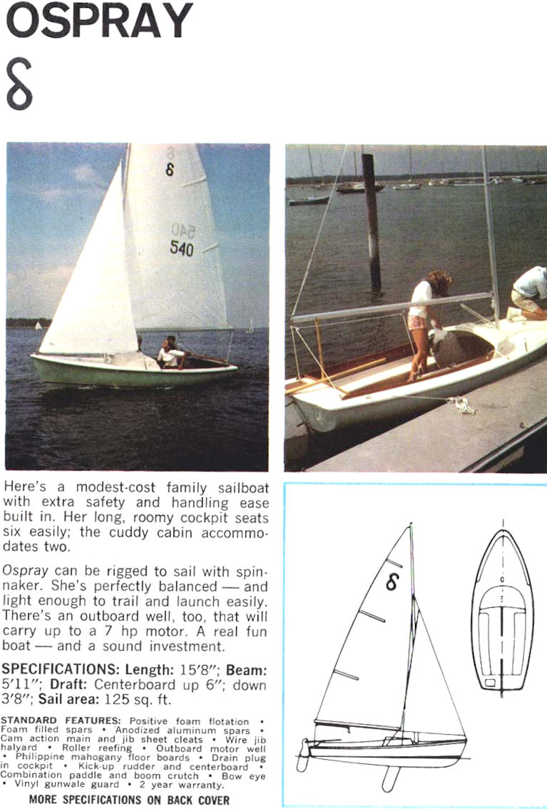

A friend of mine restored an Ospray a few years ago, then gave it to his daughter who sailed it. I remember my friend rigging the boat in the yard, boom wasn't too low. If your sails are correct for the boat, they will have a symbol on that almost looks like a figure 8, but is really an "O" inside the bottom part of a "S". The OSpray was only made for a few years in the late 60's. If your sails are originals, you might want to send the sails out to be cleaned and have new resin put back on, cheaper than new sails.

Postby jeadstx » Mon Oct 19, 2015 1:09 am
Attached are pictures of the Ospray from the 1968 O'Day catalog.

Postby ejaj » Mon Oct 19, 2015 6:58 pm
My boat looks just like the one in the photos, only it's a wonderful 1960's blue/green. The boom end is higher in the photo than on my boat. I did get an estimate from Sailcare for a refurb/cleaning, and will likely give it a try. Thanks to everyone for their comments. Jim

According to sail rite, the luff of your main should be 19.8". It is possible the luff has stretched so your boom rides low. It is also possible that the main has not been fully hoisted.
