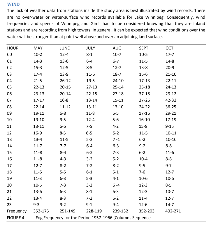

My first plan with this little boat is cruising around Lake Winnipeg. It is the largest lake in Manitoba, and it is the twelfth largest in the world, with a surface area of 9430 square miles.
I have found some wind condition info.

About wind data: Looking at wind data is a good start, but in your picture, it's unclear what they mean. Are they in km/h, knots, or m/s? Knowing that would make a huge difference. Also, do I understand that these simply list max-min for that hour for the whole month?
