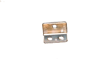

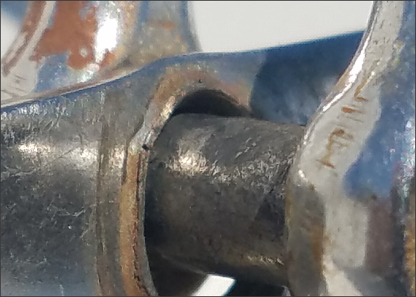

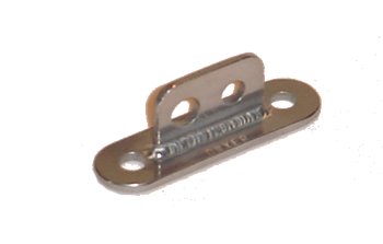

I am considering replacing the two sidestay chainplates with headstay stemheads. As my boat is put in and out of the water with a little crane, and is connected at three points including the two chainplates, I am worries about the chainplates' holding up over time. See the photo of the wear they are incurring. The stemheads, with their two holes for fastening, can be used for the stay and the crane, each connected to it's own hole. I don't think DR sells a backing plate for the stemheads; I would have to fabricate something, probably out of galvanized steel.

Postby GreenLake » Tue Aug 11, 2020 2:47 pm
If the DSIII is like a DSII you could fit a bit of "half-pipe" as backing plate under the hull-deck joint. That's what people did on the DSII to beef up things. Might browse way back in the DSII archives to see that discussion.

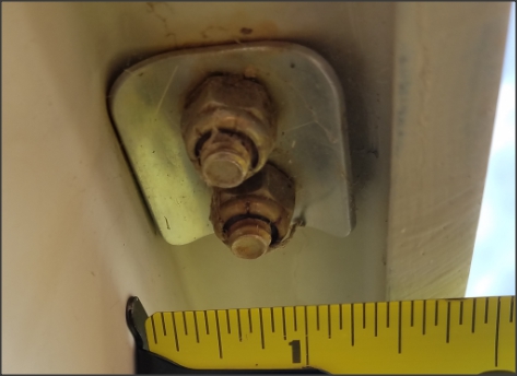

Postby SMichelsen » Tue Aug 11, 2020 5:08 pm
I found your old post ... viewtopic.php?f=12&t=5632&p=31949&hilit=half+pipe+backing+plate#p31949
Yes I see that the stock chainplate has a curved bit of stainless as a backing plate. I am not clear why that's better than a flat plate. Of course I would opt for stainless but DR Marine doesn't sell it.
If I were to go with the pipe idea, is any sort of pipe OK? Black pipe? Maybe a length of pipe can be longer than a plate, and spread the load further?

Postby GreenLake » Tue Aug 11, 2020 7:04 pm
Good for locating that post. Instead of pipe, you could get a section of stainless steel rod as well. Not black pipe, because you wouldn't want the rust stains. You may find a specialty shop that can sell you a length of SS pipe or bar of the correct length, or perhaps even drill the holes for you.
Round: because the area is configured in a way that a flat plate guaranteed to fit (including tolerances for any boat) would be too narrow. You can see that in the picture: the inboard end, by curving, can be a bit wider than a flat plate would.

Postby SMichelsen » Wed Aug 12, 2020 12:48 pm
OK, here's what I bought: a piece of 5/16" thick x 1" wide x 12" long 304 stainless, that I will cut into two 6" long bars and drill two holes to work with the hardware I order from DR Marine. Have a look here. I believe that I have 1" of flat width to lay a 1" wide bar in. I figure the 6" length will spread the load of picking up the boat better than what's there now. Thanks much for your input!

Postby GreenLake » Wed Aug 12, 2020 1:56 pm
And if it doesn't fit flat, you can round corners on this as needed. Looks good.
