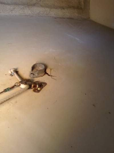

Postby ChrisB » Thu Sep 18, 2014 8:11 am
Does the look like the attached photo (crack in the cuddy floor) ?
Chris B.
ChrisB
Posts: 345
Location: Melbourne, Florida
Re: Cracks in deck around mast
Postby Moose » Thu Jun 18, 2015 10:25 am
Chris B,
I just saw this, sorry for the very long delay.
The cracks I have are in the Gelcoat around the tabernacle on the cuddy top. Your damage looks structural, but repairable.
-Moose
