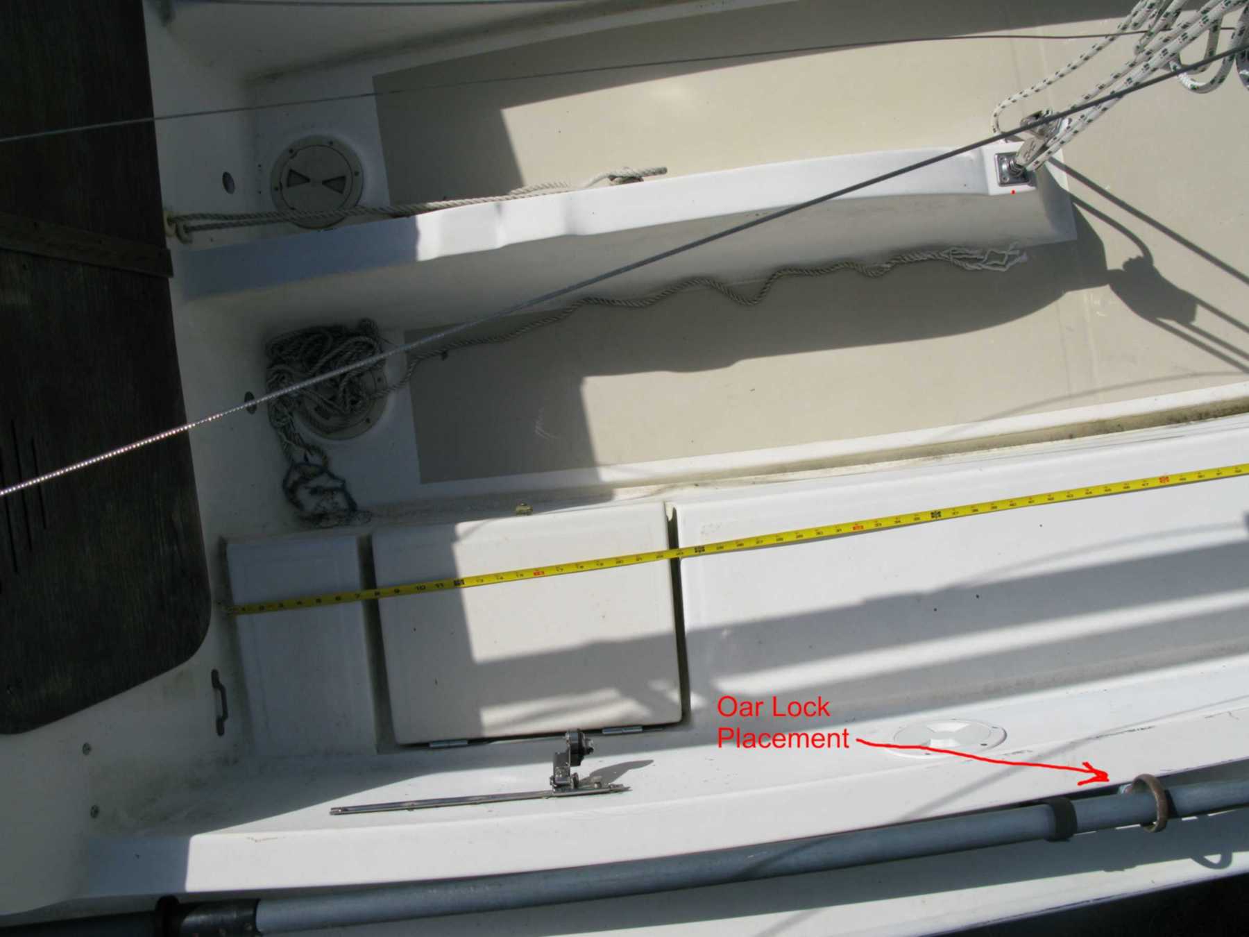

The oarlocks are placed in line with the mainsheet attachment at the aft end of the centerboard trunk. I installed 4" inspection ports to bolt my oarlocks to the boat. I placed my ports forward of where I wanted my oarlocks with the idea of being able to access my jib tracks as well. My mistake was using a 4" port and placing them forward. The port should have been a 5" (maybe 6") rather than 4". The 4" port is too small to work with. The port also should have been dedicated to the oarlocks.

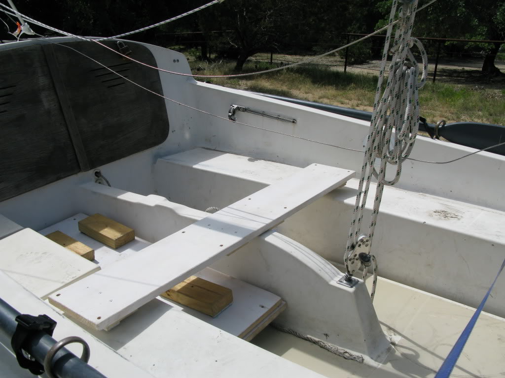

The rowing seat I made was from 1x8 or a 1x10 board (can't remember) that was cut long enough to span the width inside the cockpit with the ends supported by the seats and the center supported by the centerboard trunk. Because of the angle of the seat tops I put small blocks on each end to deal with the angle. In the center I put blocks on the board on each side of the centerboard trunk to keep the board centered for rowing. There are posts on the forum concerning oars and some better rowing seats than mine.

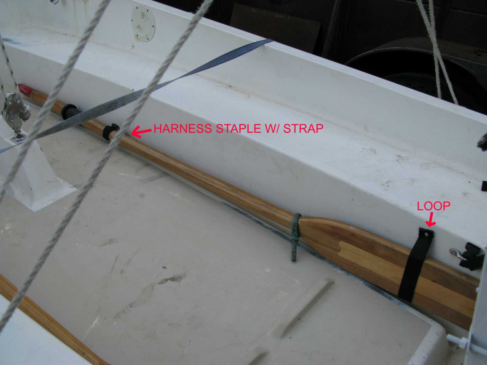

The oars that I am using are too short, only about 7' long (it was all I could get at the time. The oars really need to be about 8.5' long. I originally stored my oars along the cockpit on the side deck to keep them out of the way. I attached harness staples that would use 1" nylon straps to tie them down. Problem was that the oar would foul the jib sheets while sailing. I moved the oars to the inside of the cockpit storing them at the base of the seat and the cockpit sole. As I recall this is long enough to accomidate about an 8.5' oar. On the stern end I installed a loop to fit the blade in and about 2/3 forward of the stern I installe a staple for a 1" nylon strap to secure the oar. With one securing strap and the blade end in the loop it is easier to get the oars out when needed. When I have the boat heavily loaded for camp cruising, I store the rowing seat in the stern strapped down across the seats, sometimes with a solar panel mounted above.

Lucas, I'd second John in that the 7' would probably be too short. It's possible to row the boat, I've rowed someone's DS with that setup, but the ergonomics are poor. Better than paddling, but not something I would do for the long haul.
I'm surprised the oars fouled the jib sheets when stored on the side deck. On my DS1, I routinely store paddles on the side deck and never had them interfere with the sheets. After using them, I place paddles flat with blade wedged between stays and cuddy walls, which keeps the paddles on board without anything else to secure them. I stick the paddle forward, turn it, so it lies down flat, and pull back to wedge it in place. (After they have dried out, I store them under the side deck - that's a space not available on later DS models).
Storing them the oars the other way around, handle to the front, might possibly provide something that the jib sheet could wrap around.
Now, with paddles, John's current solution (inside the cockpit, against the seats) would seem to work well on a DSIII.
