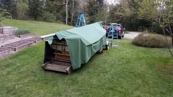

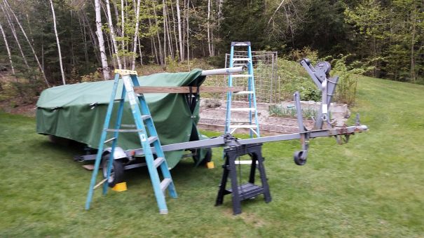

Using the trailer jack method, I got the stern onto a homemade cradle then suspended the bow eye from a 4x4 post between 2 step ladders. The post I had lying around was only long enough to pull the trailer forward barely out of the way of the trunk. A 10 foot post would allow you to easily walk the trailer all the way out. I then placed and shimmed a couple jackstands—padded at the top--under the boat to team with the slung bow. This setup permitted carefully stepping into the boat center cockpit. A couple of 2x4's cut to length as gunwale supports might have helped stability. When I careened the boat years ago, I didn’t like testing the board function while it’s weighting to one side.

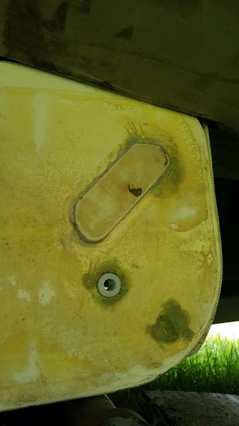

The bottom was about 19” above ground, so I could only lower the board about 30 degrees, but that’s roughly the loudest angle in the water. Test wobbling made it seem like the top of the board was hitting the upper trunk walls as much or more than the mid board was hitting the trunk opening. So I decided to attack both areas by shimming the upper board itself and the trunk opening. (Poke) testing shim thicknesses before dropping the board told me I wanted only 3/32” thickness on each side. So countersunk mini screws seemed impossible.
The tricky thing is that the trunk is not of uniform thickness. After dropping the board, a piece of wood ripped to barely fit in the tightest spot was great for exploring. Mine was narrower at, and forward of, the bolt spot. Not much—an area of maybe 8 sq in. So I avoided that spot, positioning shims roughly from 12 o’clock to 2 o’clock above and to the right of the bolt hole when the board is fully retracted. Those shims were kidney shaped about 6” x 3”. I glued ¾” wide by about 6” shims to the trunk entrance starting a little behind where the board sits when fully deployed (or 90 degrees).
I first flame treated and epoxied HDPE shims but was able to peel them off too easily. I had some plywood type stuff the right thickness and that worked out much better in terms of adhesion. I precoated all surfaces with epoxy to seal the ply.
And still, I wanted more haha. My board had the (roughly) ½” x 1” nylon bushing in the bolt hole and that seemed pretty loose too. Calipers showed that the inner bushing diameter was at least 17/32” (hard to tell since the caliper thickness slightly inhibits accuracy). So I bought some ½” x 1"UHMW tubing, a 33/64” drill bit, and new rubber washers. I had to creatively reduce the bushing o.d. to fit in the board, but that resulted in a press fit. I also made my bushing a tiny bit longer than the previous to help prevent the bolt from squishing the trunk. I used my test stick dimension of 1.14” at the bolt hole. The previous bushing had protruded from the board some anyway, so I figured why not use the last bit of space.

My goal with each modification was for improvement rather than perfection. Try not to laugh at the pix! The 4x4 is 86.5" long. Not sure if 96" would be enough to comfortably slide the trailer out all the way. But we made use of where one roller was in contact with the keel.

Champlaner wrote:Try not to laugh at the pix! The 4x4 is 86.5" long. Not sure if 96" would be enough to comfortably slide the trailer out all the way. But we made use of where one roller was in contact with the keel.
You could have launched the boat on the grass, then tipped it on its side, put something to support the keel and rotate back. The boat is not that heavy, you can even lift bow or stern manually and lever more support under it. I had my boat up on two stacks that way once inside a garage. Two or three tires in for the bow, and a stack of short 4x4 like in that wood block tower for the popular game.
We did it with three people, I believe the third person was the one adding the supports.
Whatever works.

I've careened the boat before but really wanted it flat this time to test the board wobble. I considered supporting the CB while careened but was less sure I could manage it just right. Dropping a socket in the bilge is also problematic when careened!
