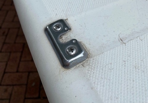

Does anyone know what these fittings are for? I have a '74 DSII and there are two on each side of the rail. The one pictured is just aft of the chainplate on the port side. The second is further aft about halfway to the stern cleat. They seem to correspond to a molded channel in the fiberglass so I assume they are factory.
Were they for oarlocks, perhaps?

attaching fenders, A plastic washer slides into the fitting. The line of the fender is attached to the washer

You can buy the plastic washer from West Marine but you can't buy the fitting. I believe Taylor makes this system.

I did some googling and the ones made by Taylor seem to be an exact match to the ones on my boat.
They can be found on Amazon by searching #1010 Traditional Boat Fender Lock and Peg Set you can also just purchase the #1009 Locking Peg for about $7 each.
