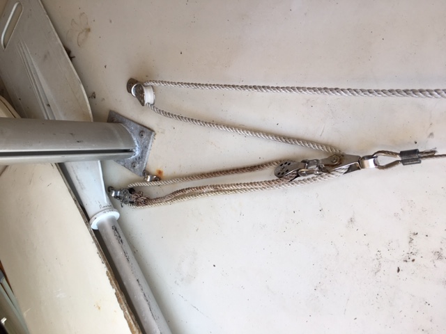

by jimfrens
Does your uphaul mechanism use a set of blocks (pulleys) at the bottom of the mast tube, or is it a direct 1:1 pull? My 84 has the blocks which give a 2:1 advantage for lifting.

by jimfrens
I got my CB reinstalled with new cable. Tomorrow I'll get a photo of the uphaul rigging and post it here.

PostPosted: Mon Sep 30, 2019 6:19 pm
by jimfrens
photos of my uphaul rigging:

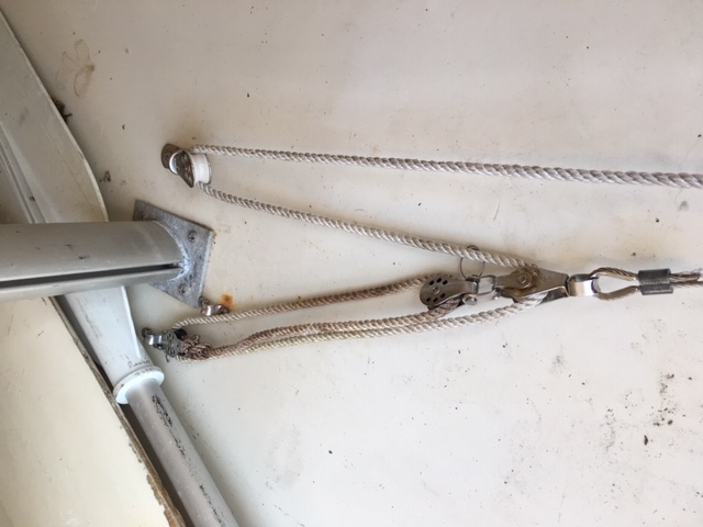

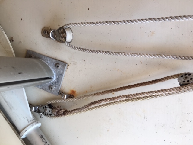

by jimfrens
more photos of uphaul rig:

by hsubman
Jim, I see your uphaul has an added block to double the advantage. The standard set-up is more or less just a turning block with a shock cord attached to keep tension on the uphaul cable. I like your set-up and going to have to try it. Thanks for posting the picture! JOHN
