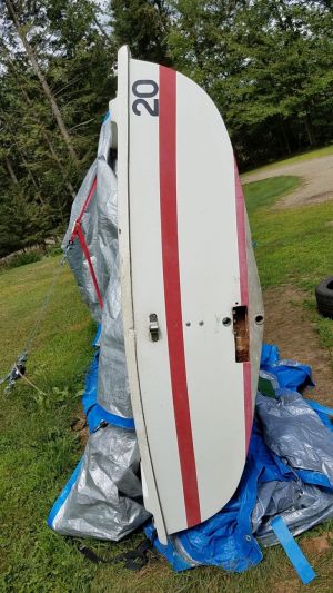

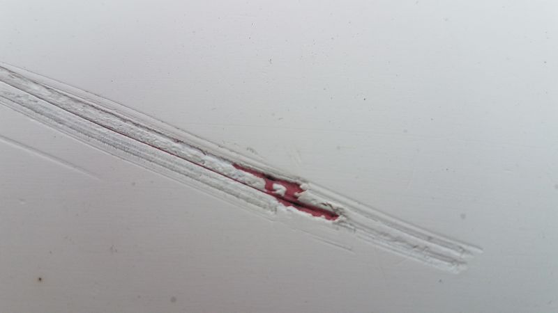

by Champlaner
I thought the same thing when I first saw the red underneath, but other dings in the hull reveal a very thick, soft white layer over the red. I'm pretty sure it's gelcoat, especially after dry sanding (with vacuum) the old ablative off the bottom into the gel. Maybe the red was sprayed first for the boot and upper stripes and the rest is all overspray? More mystery. When you sand into gelcoat, it feels like you are sculpting--very distinctive. Where the stripe is dinged through to glass, on the other hand, reveals a much thinner coat of red.

I was/am 99.3% decided on doing the minimalist repair, but since I hogged out material behind the remaining skin in 3 directions, I'm not sure if I can just push/pour some kind of filler into those areas, after I borax and acetone as much as possible. I would use thickened epoxy, but I'm nervous about having it exotherm too much if I try fill an area 8" x 4" x almost an inch thick. (Had a pan go smokin' hot on me first bottom coat. Used 2 pans after that.) I know I can put plywood or G10 covered with epoxy mud in those voids, but the variance of thickness and shapes will be challenging. Maybe I could stuff wads of impregnated cloth along with some structural pieces of ply/G10. Not a very sound strategy, but should give me some strength and adhesion to the skin. Once I get back to the exposed area, it will be much simpler fitting in a couple layers of structure. I'm hoping to avoid waiting 2 hours after each inch of progress in the hidden voids, but that might not be such a bad way to avoid exotherm issues.
And finally, if I change my mind again and go for the mostly total removal of the outer and maybe middle skins, will the inner be strong enough to hold everything while the boat is on it's side? Yikes. Cutting the very burly transom cap seems like asking for even more trouble in that respect.
rear view.jpg (67.72 KiB) Viewed 12000 times
Have a nice weekend all, and thanks GL!!

A post-scriptum on the red / white gel coat.
Likely production sequence: the boot stripe got masked off, all white gelcoat sprayed, the masking removed, and red gelcoat sprayed. That would make the inner red the overspray, which fits, as gelcoat is sprayed on the mould.

by Champlaner
I'm not sure the red is gelcoat. It's very thin and appears to be glass just under the surface. And I think it came that way from the factory. Especially now that I've seen 109jb's identical stripe. Maybe it's just a thin coat, but I didn't think that was possible with gel. I can barely feel a difference between the stripe and the hull with my finger, so I'm still confused about the how. Anyway, it's a nice shade of red!
