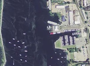

I was going to ask more details about the approach to your dock, but I think I found the satellite view online. A bit tight, similar to some of the marinas here which I have sailed around in to check them out. Tacking needs more than 20 feet, but if you have the momentum, the DS is just very sweet and maneuverable. Our dock has a long and narrow channel, but "narrow" means 50 ft side to side (lined with expensive boats). Tacking in and out that one works well. The one you sailed out has a bit more of a bottleneck, but it looks short and because it's an intersection, you can plot all sorts of angles though it. That should help.

Thanks. The google satellite doesn't show how crowded it is. This picture really shows how tight it is off the ramp ( the wide square part to the right). Literally, there is a dock with boats directly across from the ramp, not 40 feet away. Then, you have to squeak through a narrow canal to the east to get into the channel. I need to tidy up my reefing setup. I need to do a jiffy reef with a better out haul and definitely a topping lift and reefing hook. Those are my next purchases. I read the stingy sailor website, and will rig both the way he does it.

No, I used the Jenkins Pier ramp as shown in the photo. I considered taking out at the CG station, but it was full of some kind of training exercise.

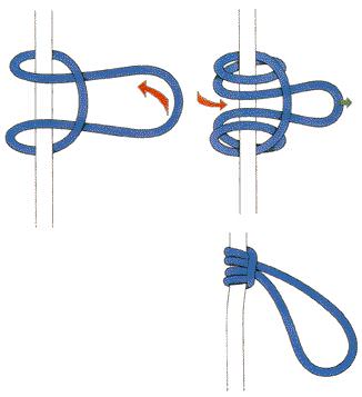

Ok, thanks. What is that kind of connection on your jib? it looks like you wrapped one line around the jib sheet. Why do it that way? It doesn't seem like it would slide like a self tacking jib, unless you have a traveler setup out of frame.

The "line wrapped around the jib sheet" is a loop that is wound around the sheet in a Prusik knot.
Prusik loop
However, in order to be able to disconnect the sail, the loop is cut, and one of the ends is an eye, and the other a bulky knot (Diamond knot).
There's a lovely site L-36.com that has instructions how to make "soft shackles", and that (or something similar) is what I am using for this loop.
A Prusik knot can slide, but only if it is unloaded (that is, you can push it manually up and down, but not pull it). Mine has not budged from its position in the middle of the jib sheet. I leave the jib sheet rigged, even if I take the mast down and the soft-shackle gives me a quick-connect to the sail. (You never want to use metal shackle there....because of flogging).
It is less bulky than having two bowline knots; I did not have to cut the sheet; and, finally, the sheet doesn't tangle as easily (my jib generally does not get hung up, even though I have lots of bulky stuff around my mast base.
Material: Amsteel from Samson rope - doing a splice in Amsteel is kid's play, but you need quite a bit of extra length for tucking. (When using a diamond knot for the purpose here, you trim the little tails flush, no need to have them out and whipped as shown in the linked image).
