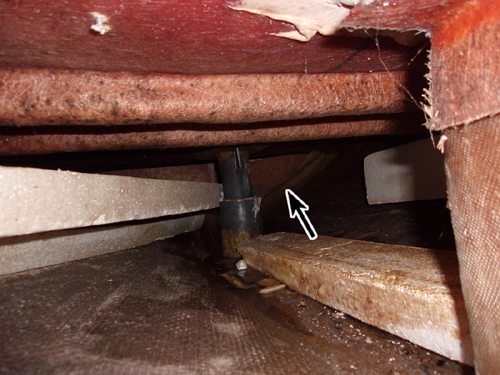

The tabernacle attaches to a mast stub, which in turn attaches to a compression post in the bilge. The compression post is fiberglassed into position and the stub is usually attached to it with screws. The screws pass through the cuddy floor into the compression post.
Here it is:
DSII compression post resized.jpg (189.65 KiB) Viewed 17298 times

Shagbark, what year is your boat? Mine's a 1980. I'm wondering when O'Day decided to add the compression post.
I can see why they did add it--my cuddy floor is flexible when I climb in there, and I don't weigh all that much. Tightened shrouds and forestay generate a lot of downforce. The idea that all of that downforce is concentrated in a point load at the base of the mast, on a fiberglass panel that isn't especially strong, is kinda scary.

I think all DS2's have the compression post. The screws seen in the pic are holding the step casting to the cuddy sole, preferably directly over the post. The mast hinge instructions from D&R suggest drilling a horizontal hole through the stub/step casting, and using the forward hinge pin to hold the stub down while stepping/unstepping the mast. On TRW I just secured it with a SS self-tapper and never had an issue.

I think Tim's right, that all DSIIs had the compression post. Shagbark, may I suggest having a look in your bilge using a small inspection mirror lowered through one of the ports aft of the cuddy bulkhead, with a flashlight pointing at it? I'd bet you'll see the compression post lurking there directly below where the mast stub rests on the cuddy floor.
