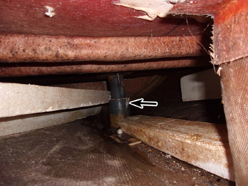

DSII compression post resized.jpg (189.65 KiB) Viewed 15966 times
Here's the photo from the other thread. It's a metal post that extends from under the cuddy sole to the keelson.
With a combination of determination and gymnastics, you can look at your own compression post by holding a small inspection mirror in one of the inspection port holes aft of the cuddy bulkhead - shining a flashlight into the mirror will illuminate the bilge area so you can see into it.
Or you can hold a small camera in the hole and take photos of the bilge until you get one that shows the post. This may take several tries.
Or you can install an inspection port in the cuddy sole - just be sure not to cut the two crosswise stringers shown in the photo.

Hmmmmmm. I wonder if someone at the factory glassed the compression post into the keelson slightly askew, then realized that they had made a mistake and glassed the plywood reinforcement into the underside of the cuddy floor before they put the cockpit molding on.
Otherwise, it might be some kind of damage repair, but I'm having a hard time imagining what kind of damage woulds have called for that kind of fix.
By the way, the arrow in my photo is actually pointing to a built-in fiberglass flotation tank which I had been completely unaware of. I assume it's standard, but who knows?

It's kind of hard to tell where that arrow is pointing. Is it supposed to be "pointing" at whatever pixel is closest to the tip, no matter how deep that is in the background of the picture? Or do we follow its direction until it intersects something that's closer to the foreground?
Haven't been in a DSII in a while, but I believe you are correct there's a bit of a tank forward. In the picture that would form the background. There seem to be a pair of stringers, the underside of which is above the arrow.
Then there are some light gray bits that I can't place / identify. I assume the thing looking like a light brown bit of 2x4 is the keelson and the shape to the right of it is part of the CB trunk? If so, forward direction along the centerline of the boat would be 30 degrees away from bottom right corner. Is that what we are seeing?

The arrow tip is just below, and meant to point to, the bottom edge of the flotation tank's rear wall. It isn't relevant to the question about the compression post, but this was the best photo of the compression post I had - I probably shouldn't have mentioned the arrow and confused the issue. :D
I've put the arrow where it should be for this topic, so it points to the compression post. Here's the new photo:
DSII compression post - resized.jpg (188.95 KiB) Viewed 15682 times
The bit that looks like brown 2X4 is a length of flotation foam, as are the two gray bits to the left and the single gray bit to the right. They're too long to pull out through the inspection ports without breaking them, so I suspect they were dropped into the hull during construction, before the cockpit molding was attached.
GL, you're right about the 30 degrees, and the portion of the centerboard trunk, and the two crosswise stringers.
Actually, looking at the compression post, and the compression post in one other DSII, it looks to me like it was made in two pieces, top and bottom. (The top portion is narrower and fits inside the bottom portion, and the drips of goop on the lower portion were probably glue that was squeezed out when the two pieces were joined.)
O'Day must have glassed the bottom portion to the hull and the top portion to the underside of the cuddy floor, then hoped they lined up when the cockpit molding was lowered onto the hull molding. If they didn't line up, well, desperate times call for desperate measures, like maybe the plywood in Kevin's boat.
That's my theory, anyway.
