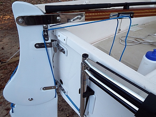

I know this has been covered in discussion but I can't seem to find what I'm looking for.
I want to add these lines for my rudder and I understand about the auto-release cleat for the downhaul. What I'd really like to see are photos of how others have actually done this. Specifically I'm interested in seeing the attachment points on the rudder itself and the routing of the lines through or around the rudder head. I currently just use a decent amount of pivot bolt tension to keep it down or up but its a pain to force the rudder back down by hand when it rides back up. Loosening this pivot tension and using the lines seems like the way to go. We're talking about a stock DSII with no tiller tamer. Just a nice telescoping extension on the tiller.
Please post pics or links to galleries if I'm missing them.
As always, thanks in advance for the help.
Eric

But here's what I did - I wanted to keep it as simple as possible, so I just used some small cheek blocks, and ran the lines as shown.
The down haul is just run through the lower pintle - Note that these are NOT the stock rudder hardware, so YMMV.
I made large dia. plastic washers to fill the clearance between the rudder blade and head, so I don't think the lines will wedge there.
One thing on that nice break-away cleat -
If you mount it on a nicely varnished tiller, beware that if it trips hard, it will snap over with enough force to put a nice little divot in your varnish :-(
I made a little stainless steel plate to mount it on, after the fact ........
rudder lines 1.jpg (240.27 KiB) Viewed 11306 times
On the up haul, I did the same thing with the cheek block, but just ran the line over the outside of the rudder head as you see.
I may add a small fairlead, just to keep the line in the "groove" - We shall see .....
Note - I cut away a little of the top rear of the rudder blade, to get it to lift just a bit higher, for beaching / launching purposes.
So again, YMMV
The cheek blocks worked nicely for me, as the top mounting holes share the same screw as the tiller stop - Once again, not a stock item.
So, I'm not saying that this stuff is THE way to go - Just what I did

Perfect! This is exactly what I was looking for. Thank you.
Is that 3/16 Sta-Set? Its a very clean looking mod and clarifies what I need to do. Excellent photos too. Ok, this is off topic but which swim ladder is that? It looks like the one I was looking at to add this Spring (Five Oceans).
Thanks again.
Eric

itguy1010 wrote:Is that 3/16 Sta-Set? .
Eric
I doubt it's Sta-Set - It is decent 3/16" polyester though - I was "gifted" a couple 600 yd spools of it, many years ago, by another sailmaker.
I use it for all kinds of things - It makes a most excellent clothesline :mrgreen:
The swim ladder - I don't recall who I actually bought it from
I think it is similar to one Five Oceans sells - It's a 2 step ladder - I just shopped E-Bay for the best price.

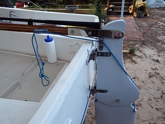

Postby Alan » Sun Apr 09, 2017 11:08 am
Good-looking boat, Tom.
In the second photo I see two inspection ports. I'm guessing the upper one is for access to install a turning block for the starboard spinnaker sheet. What's the lower one for?
Re: Rudder Downhaul and Uphaul Rigging (again)
Postby FloridaTom » Sun Apr 09, 2017 3:09 pm
Uh Oh - Thread drift .......
The upper ports were for access to the rotten plywood backing for the stern cleats -
They obviously could also be for any other purpose - blocks, etc
The lower ones were to access the interior of the transom, to mount outboard bracket, and swim ladder - Everything is through-bolted.
The plywood inside the transom was also history, for the most part - But THAT'S a whole 'nuther story .......
