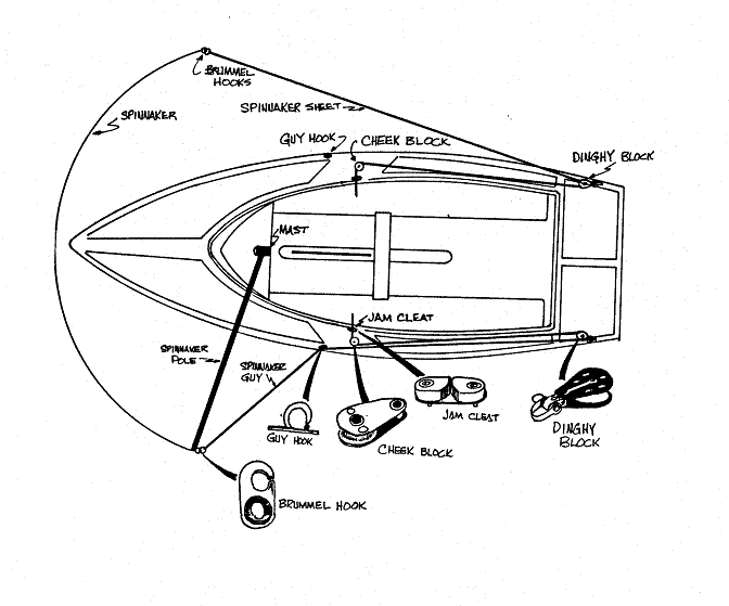

Also what are these for? Just forward of the chainplates, the black part is rubber.

windwalker wrote:Also what are these for? Just forward of the chainplates, the black part is rubber.
No idea - fairleads for something?
Those are fairleads (or Guy Hooks as labeled below) for the spinnaker sheets (sheet on one side, lazy guy on the other depending on which tack you're on). At least that's what I use them for on my boat. Probably means you have other spinnaker rigging hardware such as cheek blocks mounted on each stern quarter (labeled Dihghy Blocks in the diagram) and perhaps a bail on the front of your mast to attach the spinnaker pole or whisker pole. Now you just need the spinnaker and pole and you're ready to haul butt downwind. :D
See attached:

by windwalker
That diagram explains a lot. It surely seems like my boat is all set up for a spinnaker, that's cool.
