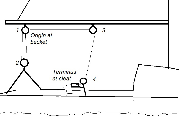

Does the previous discussion mean that in a simple stern-traveller system, the proper placement for a ratchet block is on traveller itself, as in the attached diagram? Block #2 is the only one with a 180-degree wrap.

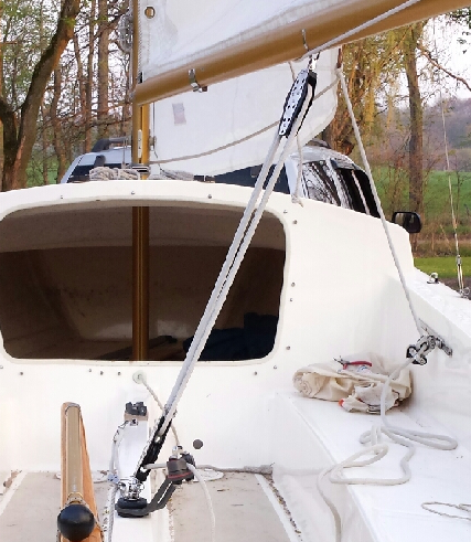

Ok. Well, I guess we'll see how it works. For clarification I added a not so great photo of my current system:
And here's what I ordered:

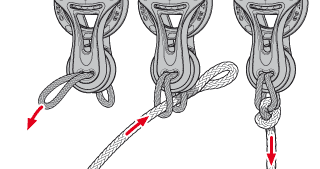

And if all else fails, I think I can do this to create a "becket", turn it upside down and install it at the CB trunk:
Comments? And please forgive my relative ignorance in this matter. All the help is much appreciated.

No, the two choices 3 and 2 should be roughly equal. At location 3 you have the most mechanical advantage. Which is offset by having less of a wrap.
Now, the Ronstan ratchet blocks are about twice as efficient as the competition (per some sailing magazine's test - it has "practical" in the name, but I can't remember whether it's the US or the UK one :), both generally do a good job for comparison tests).
My configuration is location 3 and I've never reached the limit with it.
Some people prefer location 4, because it allows the skipper to easily reach the ratchet block to engage/disengage it. As I find that the autoratchet feature works perfectly for me in location 3 (even in light winds) that consideration is a non-issue for me, but, like itguy, location 3 was the easiest to fit a ratchet block (4 is a factory setup that will eventually be replaced, but as a unit -- for now, it's a testament to the durability of Tufnol).

itguy1010 wrote:Ok. Well, I guess we'll see how it works. For clarification I added a not so great photo of my current system:
It looks like it's going to work just fine (and there's not even a theoretical benefit from mounting this on the CB - except the ability of engaging/disengaging the ratchet - something for which I've not found a use for, once I set mine to "auto" :) )
