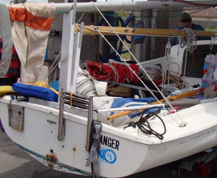

Your boat looks like it has a mounting for the rudder that is found on newer DS I boats. May be a replacement for the old gudgeons which would have covered the drain. Here is a picture of the stern on my 1976 DS II showing the bilge drain (plugged) and the above water drain (plug not in yet, I put it in before launching). The cockpit drain in the sump area of the cockpit can not be seen. All that gear in the cockpit was being put in the cuddy cabin for the Texas 200 that particular year.
My bilge area is packed with "pool noodles" for flotation.
