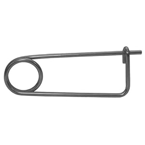

Finally, there are other designs for the pins or alternatives to the rings.
Should be easier to fit, but I don't know whether this design would be more likely to snag sheets.
I have one like the one on the left, with the ball, for the shrouds on another dinghy. They are usually set up that you need to push a button to allow the little ball to slide in, which otherwise locks the pin. They are a replacement for the pins (usually called "quick connect pins" or something like that) and super easy to use.
This might be an alternative to the rings. Not sure if it has a higher risk of coming off, but, especially if secured by a bit of tape, might be fine.

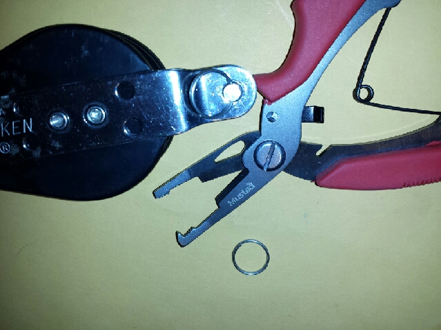

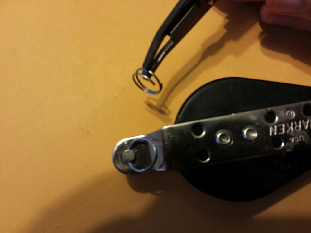

Postby itguy1010 » Sat May 09, 2015 8:28 pm
Great info as usual GreenLake. Thanks. I know, practice makes perfect. It will take some time but I have to say that my new split ring pliers work great.
Picked up this pair at WallyWorld for about $8.00 in the marine parts aisle. Anything that will make it easier for my wife to get the ring dings into the stays as I'm securing the mast tabernacle.
