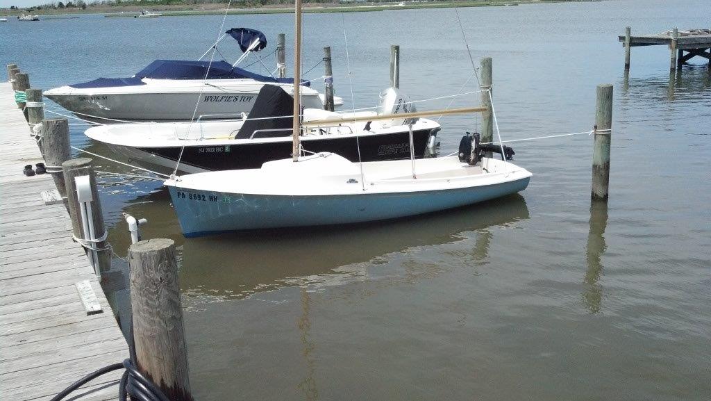

Postby Tipster1 » Mon Jun 23, 2014 7:16 am
I finally broke down and rented a slip nearby so I can come and go more easily. To minimize carrying stuff, I'd like to keep rudder in or on boat. Slip is in fairly shallow water and somewhat sheltered. Wind direction is variable.
2014-06-20_13-22-04_698 small.jpg (98.32 KiB) Viewed 17802 times
What is advisability of leaving rudder on or in boat?
What is suggested optimal position for CB in dock? Up or slightly down?

Postby GreenLake » Mon Jun 23, 2014 12:38 pm
You certainly don't want to leave the rudder attached.
Does your cuddy have locking doors? Or even doors? If yes, then you could at least keep the tiller out the sun.
CB - I would think wants to be raised. If you leave it down, it will try to resist the rolling motion of the boat in response to every wave. As you are not on the boat, there's no benefit to you, but it will stress CB and pin. Even a little will add up, because the boat spends far less time sailing than in the slip.
My 2¢. But admittedly not based on first hand observation.

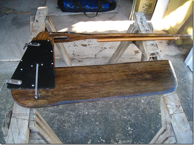

OK Tipster1, if you think removing the tiller is cheating, how about my rudder head modification.
Re: Docking
Postby Tipster1 » Tue Jun 24, 2014 5:39 pm
Fantastic! Actually reminds me of the rudder head on my previous boat, an AMF Sunbird. It didn't sail as well as the DS, but it had some much improved designs, which I wish I could add to the DS. Nicest was a spring loaded system that was both a rudder lift and a rudder hold down. Two pins and two springs designed to either hold rudder down or pull it up when it deflected past a certain point. Principle is eassy, but I don't feel like drilling holes all over the place to experiment.

Postby jeadstx » Tue Jun 24, 2014 6:45 pm
I have the pictures on Photobucket. I attach the thumbnail to my post. I made a new rudder head to allow the blade to come up out of the water for dealing with very shallow water when beaching my boat on the Texas coast.
