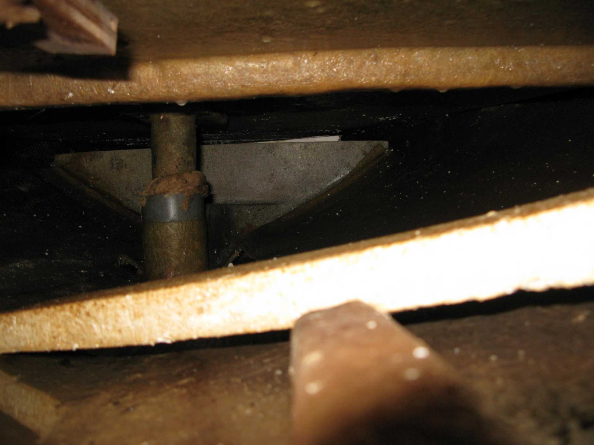

Postby jeadstx » Wed May 21, 2014 11:40 am
Attached is a picture of my compression post below the cuddy cabin floor. Might give an idea of what you are dealing with. I've added two 6" inspection ports in my cuddy cabin floor to get better access under there.

Re: Mast Compression Post Failure
Postby TIM WEBB » Wed May 21, 2014 11:48 am
You beat me to it John!
Chris, this is the best pic I was able to get of the post on The Red Witch. Still kinda hard to see what's going on at the top, but at least you can see where the stringers are. You can also locate their position by knocking on the cuddy sole, like trying to find a stud behind drywall ... ;-P
Postby ChrisB » Wed May 21, 2014 1:00 pm
Thanks for the pics guys. I was not able to get my daughter's camera to flash last night so all I got was a bunch of very dark images! These pics help me understand what I'm dealing with. Based on: 1) the slack in the standing rigging, and 2) the cracks surrounding the mast step casting, I believe that I have a rotted piece of plywood on the underside of the cuddy floor. The missing plywood is not distributing the compression load of the mast and resulting in the cracking in the floor around the perimeter of the mast step casting.
Replace the wood, epoxy the cuddy floor back in place, and I'm back on the water.
