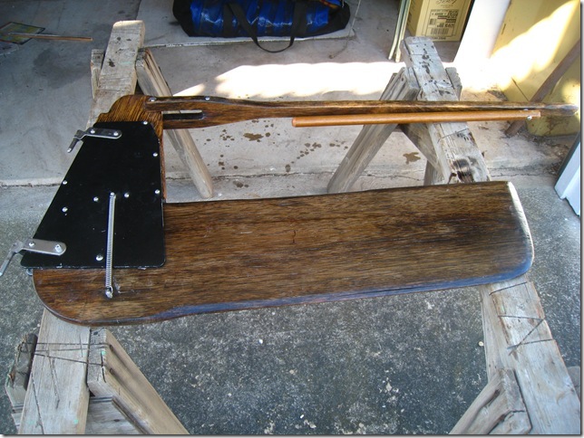

Postby Tipster1 » Tue May 28, 2013 3:28 pm
I recently purchased an O’Day Daysailer II to replace my Sunbird. I am hoping the slightly bigger cockpit and width will be more comfortable, particular for two couples on shallow NJ bays. I’ve spend time familiarizing myself with the boat through the Daysailer.org site. One thing I was surprised to see missing was some sort of spring assisted rudder lift/hold down mechanism as is present on the Sunbird.
(Please try to refrain from laughing at my Sunbird broom handle tiller extension - mahogany is hard to find around here.)
Does this exist? If not, I am looking for suggestions to hold down rudder other than friction and raise rudder when maneuvering in shallow water.

You can rig an uphaul and downhaul line, but then you would want a cleat on the downhaul that releases when you strike anything with the rudder. Looking at your photo, I see no particular reason why a spring loaded system might not work, except perhaps that the DS (stock) rudder is rather heavy and you might need beefier springs.

Thanks for replies. Cleverness of the Sunbird design was way springs moved and functioned to hold rudder down or up. Before I tried reinventing the wheel, I wondered if anyone had done this. If not, drawings or schematics for line operated systems would be appreciated if such exist.
I've plowed through a bunch of Centerboard posts (search doesn't work well because there are too many references and search engine just quits) and want to fashion some sort of bungee system to keep everything taut, but releasable, when down, and untangled when up. Any suggestions for this would also be appreciated.

One of jdoorly's designs includes this pretty clever rudder lever option.

Mine's a pretty simple UH/DH setup. Pix in my gallery. Trick to it is the auto-release cam cleat from Duckworks on the DH: pops loose if the rudder encounters an UUO. Have same cleat on CB DH.
Also, the trick to avoid CB control line jams: simply keep tension on both UH and DH at all times. Pix of my solution to that in my gallery as well ...

If you've got 500 bucks you don't need (don't we all??) Rudder Craft has an aftermarket kickup rudder assembly for the DS. The rudder can be vertically down, vertically up, or anywhere in between and looks like a much higher lift foil than the "class legal" DS rudder.

For sailing in not so shallow water but occasionally launching off a beach, the friction solution has worked fine, at the cost of having to make ground contact to get the rudder to come up, instead of being able to pull it up ahead of time. Getting enough friction to keep the rudder down was an occasional problem. Still, I resist adding complexity unless absolutely required. Your case sailing in shallows may well have different requirements.
To copy the spring-loaded design would seem to be straightforward - the geometries are not that different.
