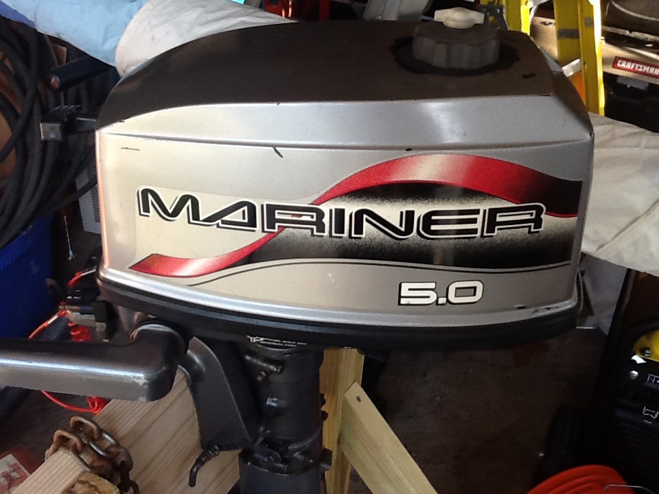

Postby Thomasjbrothersjr » Fri May 03, 2013 7:21 am
I have been reading any and every p.ost I could find on motor recommendations. I live in an area where if I bring my boat to the ocean I will be fighting currents, strong currents at both the mouth of the Merrimack River in Newburyport MA and the mmouth of the Hampton River in NH.
Of course the obvious benifits of the electric are not lost on me, but so are their short comings. Motors on both sides of the transom have their advantages. I bought a 1997 Mercury Mariner 2 stroke 5 HP long shaft.
It has a built in fuel tank. The long shaft, I believe will be a huge advantage, so much so that I spent months waiting for the right motor to present it's self.

Re: Recommendations for an outboard
Postby K.C. Walker » Fri May 03, 2013 8:46 am
I think that I agree with Thomas about the long shaft, which I also have. Theoretically, the transom height is perfect for a short shaft, but that's for a motorboat. With a sailboat that pitches and rolls a lot, it does help to have a long shaft to keep the prop in the water. If the motor was centered I think a short shaft would be fine.

Postby klb67 » Fri May 03, 2013 9:29 am
Cape Haze - do you have pics of your boat? Ours are very close in number. I have a few pics of mine as found and at the car wash on the way home.
I haven't sailed my DSII yet - hopefully soon. The widow I got it from said her husband had a 5 HP motor that he decided was too heavy for the boat. She sold it to me with the Evinrude 2 HP they used, and I think that motor will work quite well, having used essentially the same motor on a loaded canoe. They sailed the boat on local lakes and Lake Erie. I can't speak to motor requirements/recommendations for Florida.
I should add that their 5 HP motor had a separate gas tank and seemed to be quite sizable, possibly a 4 stroke. That Mariner posted above is much more like my 2 HP evinrude with the built in gas tank.

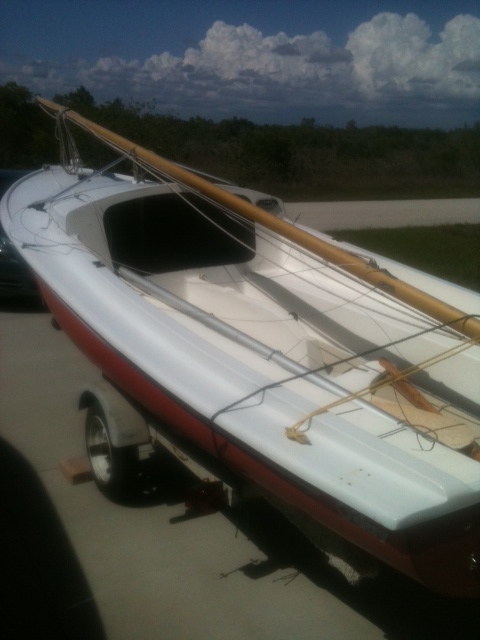

Postby CapeHazeSailor » Fri May 03, 2013 6:30 pm
Thanks to all for your input. I'll let you know what I end up going with, as with everything else it's a balancing act. Power vs. weight, etc.
As found, 5/2/2013
DS II sail #8074.jpg (86.15 KiB) Viewed 23812 times
