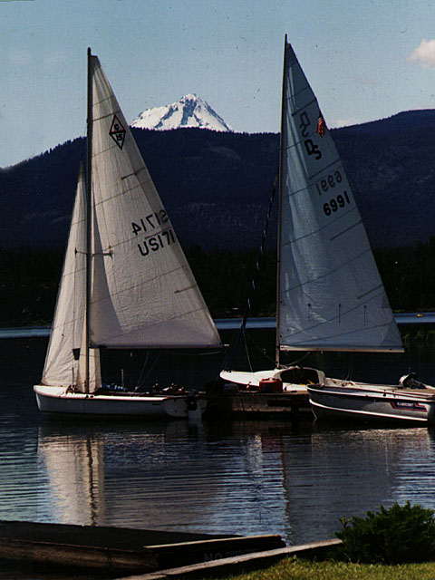

Yep, Portland. Peter filled me in on your little fleet. I still have some work to do on the boat, and the trailer so I can get the boat back to Portland, but I am definitely interested sailing with you guys. I am also in need of a rudder/tiller, if you know where I can get one, any leads would be greatly appreciated. I usually sail at Pine Hollow reservoir:
