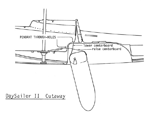

On the water in the bilge, my experience is that a lot of water can enter the bilge through the uphaul line port, in a short amount of time (in my case, a foot in a couple of hours). That's because the centerboard trunk pressurizes the water and pushes it through the uphaul port, rather than just allowing it to splash in. The water passes through the uphaul cable hole in the hull molding, but drains down into the bilge rather than passing through the cockpit molding into the cuddy.
The fix doesn't require removing the centerboard.There's a detailed description of it elsewhere on the forum, but I can't find it right now. I'll post it when I do.
In the meantime, there's a quick stopgap solution that I came up with in desperation when I was about to head off to Tahoe and didn't have time to finish the proper fix. Pull the plastic donut (grommet) out of the uphaul line hole (at the front of the centerboard trunk, inside the cuddy). Slide it along the uphaul cable to give yourself some working room. Stuff some pieces of compressible foam into the hole so it fills the gap between the cockpit molding and the hull molding, then push the donut back into position.
Then go sailing, starting with a dry bilge, and see what happens. The foam worked wonders in my case - I got little or no water in the bilge. If you still get a lot of water, the problem may be elsewhere.

I found one of several descriptions, here:
viewtopic.php?f=2&t=4949
The "raise centerboard" callout points to the uphaul cable. The "PENDANT THROUGH-HOLES" callout indicates the holes in the hull molding (on the right) and cockpit molding (on the left).
One of the posters on this thread had trouble removing the donut. Mine is plastic and comes out easily.

Postby GreenLake » Sun Feb 24, 2019 7:09 pm
Here's the image:
Were you able to complete the repair along the lines suggested?
