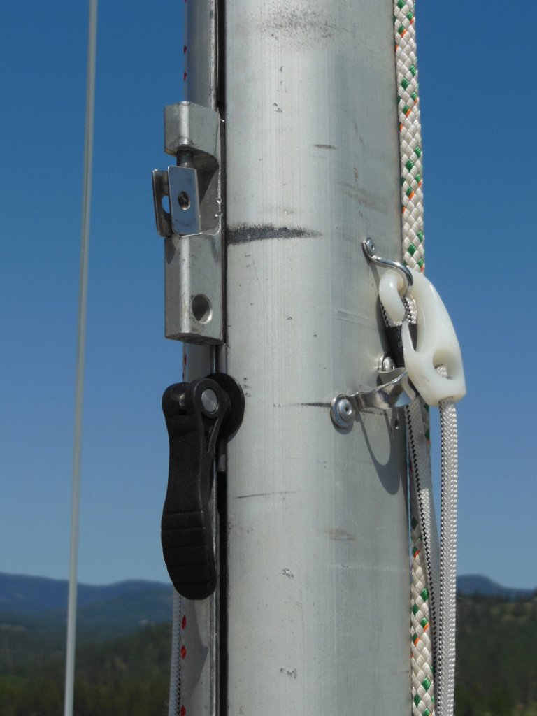

What about one of these?
Postby itguy1010 » Thu Apr 21, 2016 4:21 pm
Since this thread has taken a life of its own I'll present this question:
Has anyone tried one of these? Seems like the ticket for what I'm looking for. I really have no need (yet) for a gate since my main is really old (as in original equipment) and has no slugs. When I buy a new main next season I'm going to have slugs put in and an extra reefing point.
Its called the "QRTS" (Quick Release Track Stop):

Postby DigitalMechanic » Thu Apr 21, 2016 5:21 pm
I really don't think you are going to move that thing once you set it (I know I have not). The stopper you were looking at previously is only a couple of bucks. Not sure what that one costs. If price is negligible, it looks like you will get the same job done but with a lever instead of a twist. I would say it is really all about what you prefer and want to spend :D
