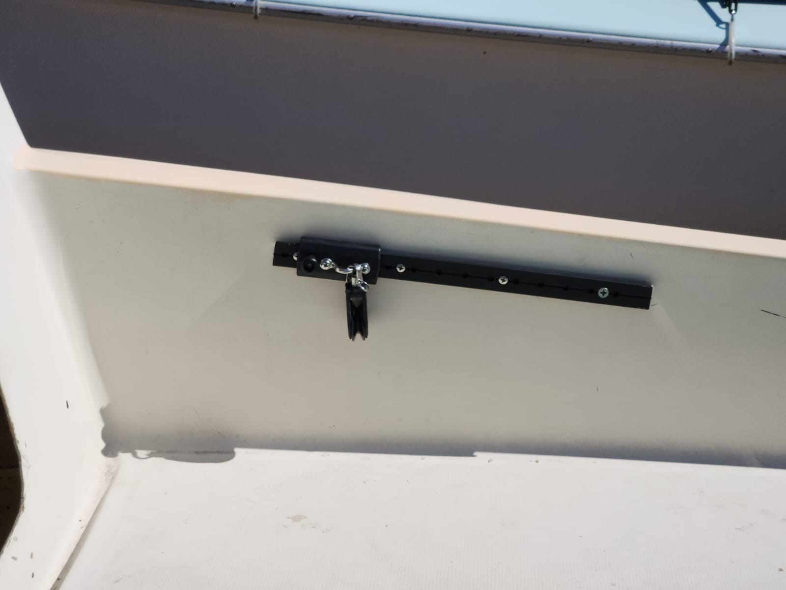

Installed jib track.
Used the Ronstan 25 t-track and composite car. Jib block is a harkin Ratchet block.
The starboard side used through bolts all the way through, the port side had good wood for ther first four screws, through-bolted for the most forward.

Postby GreenLake » Sat Sep 02, 2023 9:42 pm
Looks good.
