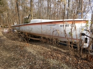

Hello,

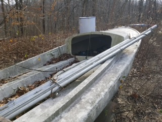

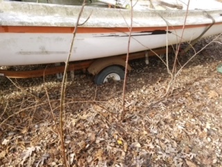

I’m looking to buy a DSII from a friend. It’s a 1978 model. They are asking $500 for it and the trailer, but it’s definitely a fixer upper, which I am okay with. I enjoy tinkering with things. I wanted to post here and see if anyone else had any input. I will attach some pictures below, but I don’t have very many. I know the mast isn’t pictured but it is included, I have seen it. I just didn’t do a very good job of taking pictures. It’s been outside since the late ‘90s. It has some minor gel coat cracking on the side of the deck but nothing major. I crawled under it and there is one spot on the bottom with a rather ugly looking repair job. That is located at the foreword most point of the CB cabinet on the bottom of the hull. Obviously all running rigging is shot from being left outside unused for 20 years. I’ve done quite a bit of digging around on the forum as far as the major issues, the CB does lower, because the lines are so old it’s tough to get it up all the way without worrying about snapping the line but it does go up most of the way with moderate pulling. I brushed the leaves out and was able to get to the inspection ports, there is some moisture in the bilge, currently ice/frost lol, but not standing water. The mast has the tabernacle. My friend did tell me she has kept the sails in a trunk in the basement. She’s older and just had a serious shoulder surgery so I haven’t seen them first hand but she says they are in decent shape. I’m a college student so money is tight at the moment so I know this isn’t something I will be able to in a few weeks and be sailing, I know it’s going to be a months/years long process of saving up money, buying parts, finding time to do the work, rinse, repeat lol. I have dreamed of one day having a cruising/live aboard boat. This would be my first sailboat and my attempt at testing the waters. I have grown up with motor boats so I am not completely new to boats. What do you all think for 500$? 500$ was the price she gave me, I’ve seen boats online on facebook and craigslist in pretty rough shape go for 1500-2000 so i felt bad about trying to talk her down much more. Do you all think that’s a fair price?

Part 2: There are extra mast pieces in the boat that don’t belong to it. The seller has a laser as well, those extra mast pieces are for that boat they are just sitting in the DS

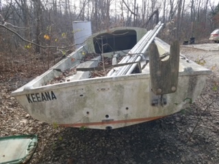

As you can see in the transom picture above there are two bolts to the left and right of the rudder attachment brackets. Any idea what these are for? I haven’t seen them on pictures of other boats. On the inside of the boat they are eye bolts, all the way through the transom with the nut on the outside of the transom

Talk about a "Barn Find".... Look, I don't know you or your financial circumstances, and obviously don't know this boat. I can tell you that my very optimistic guesstimate to get this boat into the water is about $1000-1500, and that assumes you have basic tools (drill, screwdrivers, hopefully an orbital sander) and don't' care how she looks or how well she sails. Now, I'm a very grumpy person by nature, and even moreso today :). So take this with a grain of salt - if it were me, I'd ask her how much she'd pay ME to get this boat off her property. I say that (write that) because of the wheel half-sunk into the ground. I can only imagine what state the tire, hubs, and trailer wiring are in. I'd not be surprised if the wheels don't spin at all....
OK, enough grumpiness. Fact is that if the boat is close to you and you want the project, then $500 is a reasonable point of entry (assuming there aren't any free Daysailers in same condition nearby). Up to you how much you want to negotiate with her. I'd not worry so much about the $500 and think instead about the "dealbreakers" that should make you walk away. For me, the dealbreakers would be:
1) Are the sails useable? Unfold them on the lawn, dont worry about shape (you're not experienced in sailing enough to worry about that), but see if there are any holes, rot, obvious damage, etc.
2) Is the mast OK? If you are able to, then raise the mast on the boat. Otherwise put it on a pair of sawhorse 0or chairs even) and see if there are any horrendous bends or bumps. The mast is supposed to flex, so it's OK if the mast lays down on the sawhorses/chairs in one big gentle arc.
3) Does the boom attach to the mast? There should be a working gooseneck that slides onto the mast track...
4) Any obvious weak points in the hull? The repair you describe forward of the centerboard trunk sounds worrisome. Around the CB is the most stressed part of the entire hull...
Another whole story is if you have enough experience with sailboats to know what you are looking for with points 1-4 above. Do you know any sailors to take with you to look at the boat? Lastly, my point #2 about the mast is VERY important. If the mast is no good, then getting a new one is practically impossible. Yes, you can buy one for relatively reasonable money, but shipping it will cost you $1-2K!
Oh, assuming you get this boat, do you have a place to put it/work on it? Suggestion, if you've never sailed at all, why not start with something smaller and less space/time/money intensive? Sunfish that you can throw on top of the car, for instance. Or build an 8' (or so) stitch-and-glue pram, which will teach you in both dealing with wood and working with epoxy. Just saying that 17'' of boat, small as it is, can be an awful lot of boat to deal with on land.. need a car to tow it, need a place to keep it, need a place to keep my sails, tools, etc, etc. Maybe you start simpler?
Anyway, good luck!

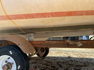

The mast is fine. The sails are fine. I know it’s gonna be a project lol. I went ahead and bought it because of some logistical aspects of getting it home having a time window. I’m young so worst case scenario I learn some life lessons. My only concern is after crawling around under it I noticed that on the port side the bottom is warped in where it rests on the trailer bunk. I hope that is something that either isn’t a big deal or is repairable, otherwise i may be shot down before i’m off the ground lol. I’m 19 in college so money is sporadic, I know it’s going to be an on again off again project as I can afford the components. I’ll attach a picture of the hull below let me know what you all think.

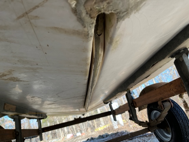

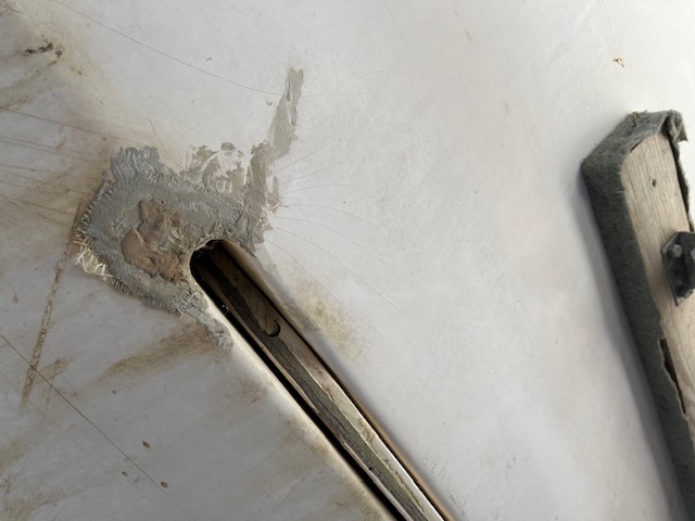

More pictures of hull

Bent in at bunkers, no problem, DS's do that. Build better bunks.
That repair looks like it's AFT of the centerboard, not forward. If aft, no problem. Sand it smooth and seal. No hurry, aft of CB is a turbulent area anyways.

The repair is at the bow end of the centerboard near where the CB bolt is.

Okidoki, then here's what you do to fix that ugly patch, at least temporarily: Sand that mess down till it's smooth in relation to the rest of the hull. Now you need epoxy and filler... I'm assuming you know how to do this from your powerboat work? If not, ask here on the forum. Mix yourself a semi-coherent paste of epoxy+filler, about the consistency of peanut butter. Now for my big trick, apply some of your epoxy filler over the sanded area, including over the bit of underlay that is showing, I use plastic putty knives, but anything will do. Then take a piece of packing tape and lay it over the epoxy fix, as smooth and flat as possible. Epoxy does NOT stick to tape. :) Once it's cured, rip the tape off and give it another sanding, done! If you mix your epoxy to the right consitency, you can do this while the boat is on the trailer, no need to flip it. Just wear protective gear! Gloves, eye protection, something for your hair, and either very old clothes or a Tyvek bunny suit. And a mask, of course, N-95 if you still got some. Assume that epoxy WILL get on your and prepare accordingly. By the way, you can get it off your skin with vinegar.
GreenLake is gonna hate everything I wrote up above :) The correct way to fix that shitty patch is to grind it out, with steps or a ramp from the gelcoat down to the underlay, then patch it with a few layers of biaxial fiberglass tape, each one progressively bigger as you work your way out to the gelcoat. Epoxy each layer in place, sand, fill, etc. IMHO, you can do that later, or just dont worry about it and do it for bigger patches elsewhere. BIG question is if you have leaks after your fix. Keep an eye on the area forward of the CB when you eventually get on the water.
